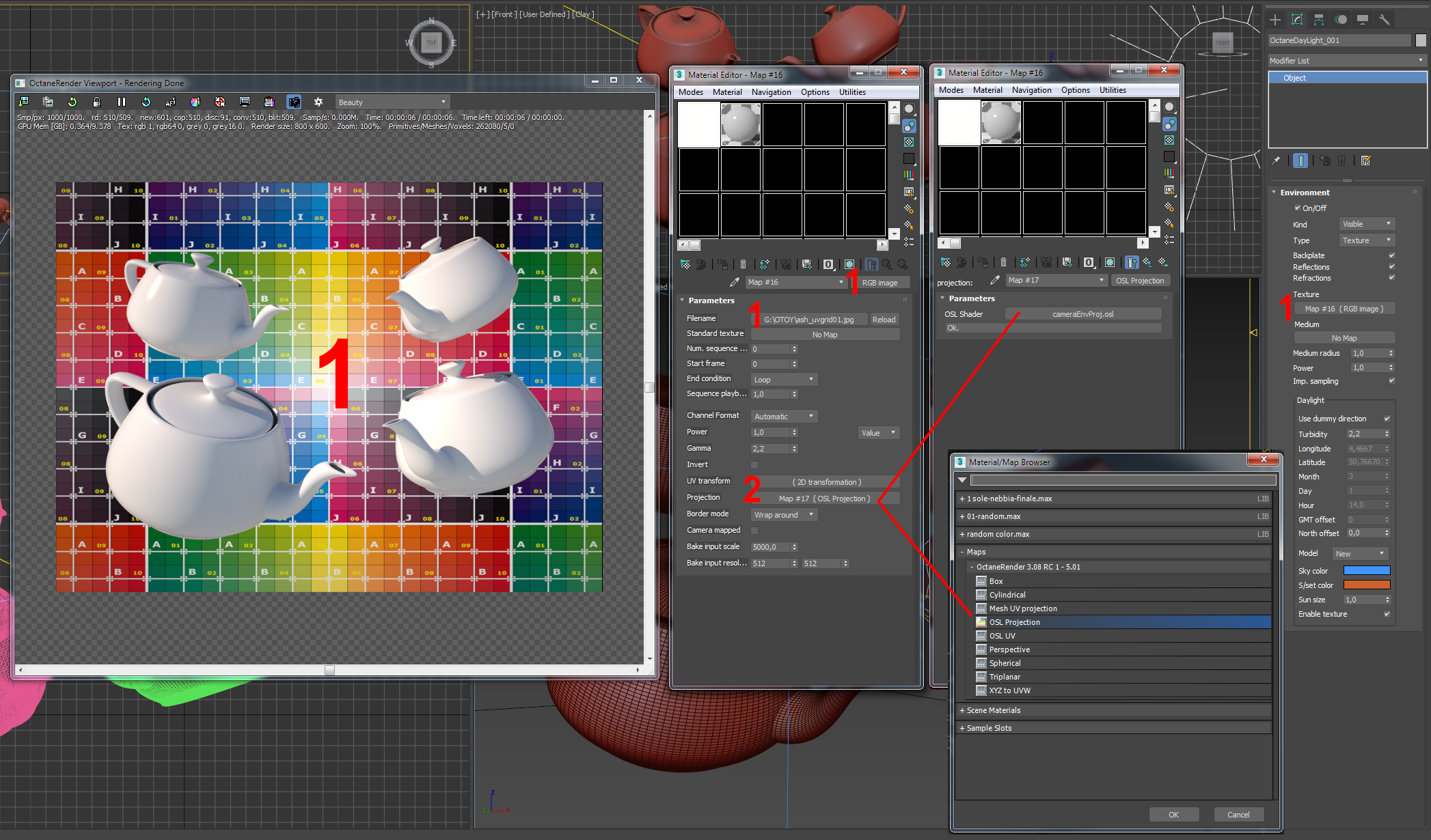

OSL projection for environment backplate - Quik tutorial
paride4331
Posts: 3991
Thanks to calus for OSL environment backplate.
OSL zip scene file updated.
osl-env2.zip
(1.32 MiB) Downloaded 252 times
calus
Posts: 1308
Location: Paris
Hi Paride, there was a mistake in my first shader version making the projection wrong when changing resolution ratio,
I have updated the script now, it should work just fine in any case :
viewtopic.php?f=21&t=65575
