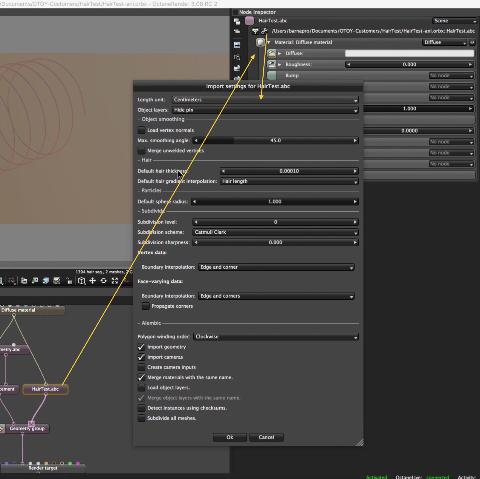

Standalone can import Alembic files with splines from v2, and you can correct the import scale and hair thickness by clicking on the wrench icon in the Node Inspector:
