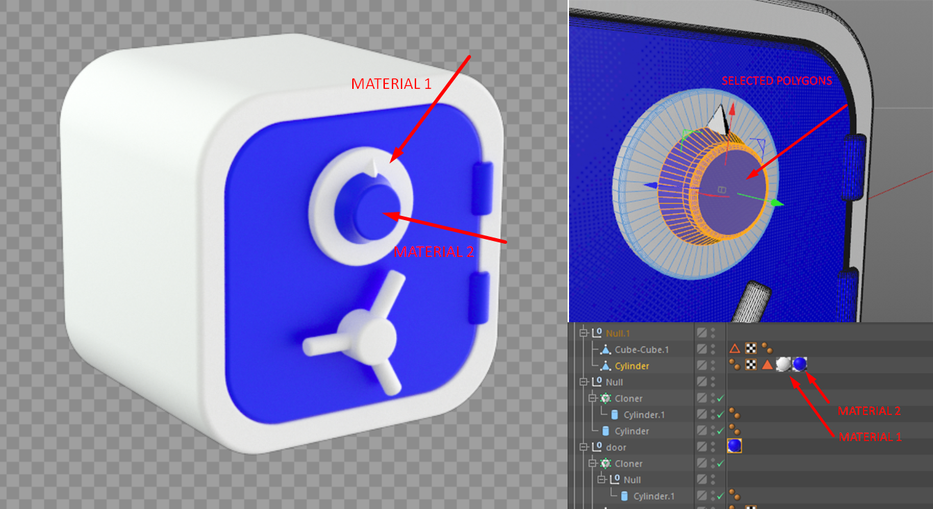

Okay, I think I know what is the issue here.
If you want to apply the material to area of polygons, you first need to apply a base material to the entire model and not just the group.
You can see that I have material 1 as a base color and material 2 for the selected group of polygons.
Before that, I had the same issue. Yes, the issue disappears if you copy and paste the model into another scene but that is not an answer for complex projects.
Hope I helped.
