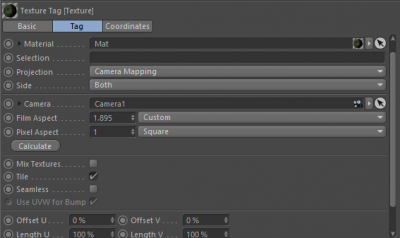

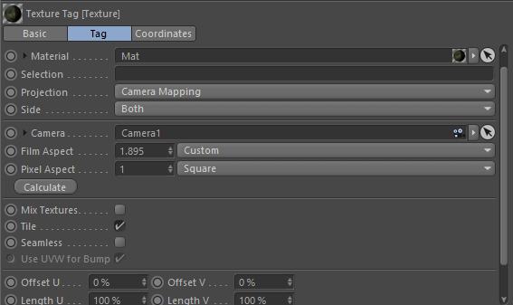

You have to use Camera Mapping material projection and select the camera you want to project from, for example:
Make sure you have your film aspect set as per your source. Are you projecting a still or video? I'm personally having issues with projecting video with this method. I can project it fine but as soon as I hit play the projection starts to drift unlike when using Cinema's renderer.
