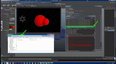

So far everything was working perfectly and stable but when I came to batch rendering in Maya, troubles, slowdowns and failure.
At this point I can deal with the slow render but the problem is that I have the render going on but the files are not really getting written on the disk, even that it shows like that the frames are rendered.
I tried Maya 13, 14 and 15 as well as many different file locations on the different disks.
I have been testing at the end only with the simple one ball scene and I have the same issue.
Please help ASAP if possible.

If you are using the DEMO version - it is one of DEMO restrictions. You can't save any files from the plugin in this version.

Yes, I am using DEMO version but let's please sure that we are talking about the same limitations.
I can, for example save Maya scene file with octane components.
Also I can go in Maya render window and save the rendered frame without any problem (watermark is the only limitation) but when I comes to only batch rendering then files are not being saved even that Maya batch is rendering and showing the file path but they aren't really being written on the disk.
