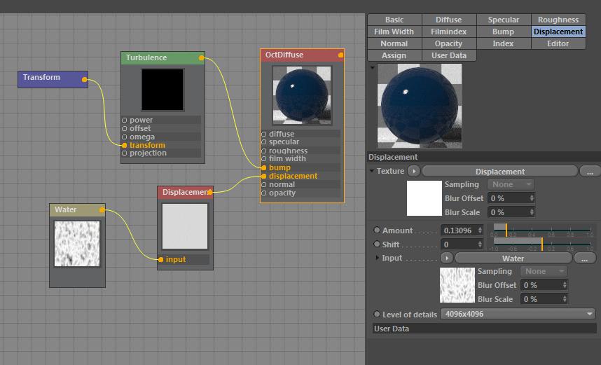

- I also noticed that I can not use the displacement option in the octane materials. It only shows me the word texture, with the arrow next to it, when I click the arrow and select noise, nothing happens, it doesnt load it at all. Am I forgetting something?

for displacement you should create a displacement node then place a imagetexture to input.

You should see a octane menu on top really. I'm not sure why don't see it. For displacement, you can check the image. It's a texture type which is in octane textures. I hope this helps.
