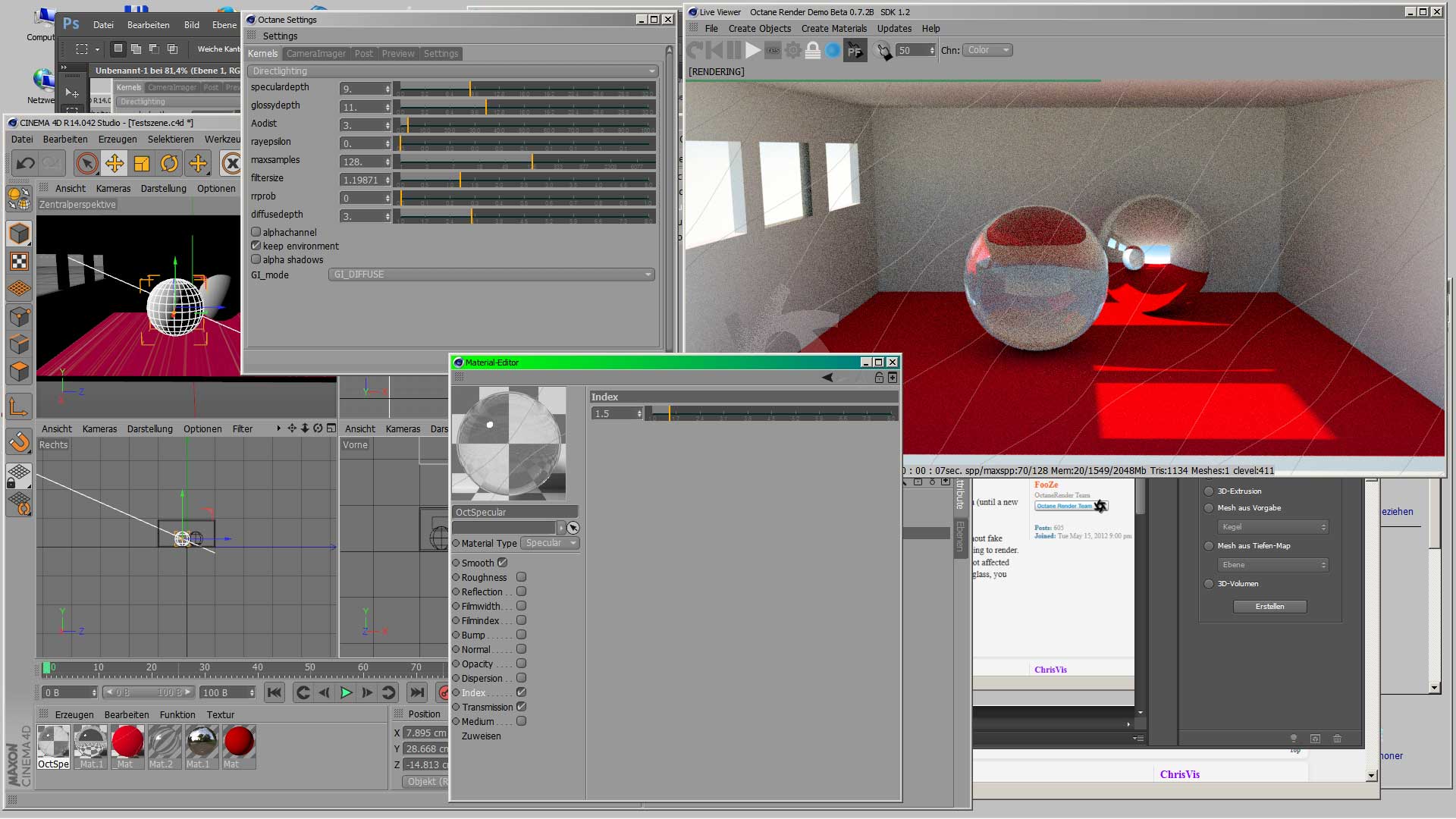

Hello,
I am writing English using Google Translate, my mother tongue is German.
I also have the problem that although glass is transparent, but no caustics come.
The light does not penetrate through the glass.
I have the SDK and 1:20 for the latest C4D 0.7.2b.
Where can switch off the fake shadows in C4D or something because I can not be?
I'm still in the trial phase. :)
Rudi
FooZe
Posts: 1335
Joined: Tue May 15, 2012 9:00 pm
Hi Rudi,
If you want accurate caustics, you will need to change the kernel to path tracing or PMC.
By default the fake shadows is off. If you turn it on you will loose accurate caustics.
The fake shadows setting is not listed in the material editor, you need to find it in the attributes window:
