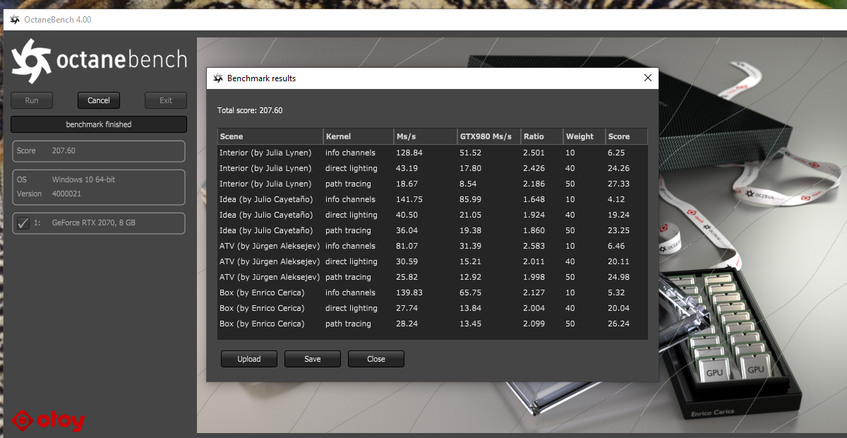

here is the benchmark result Image

@arieskew: great, your GPU is working perfectly!

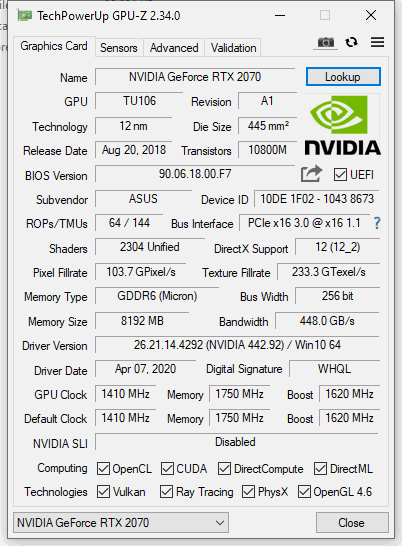

Just upgraded R23 and installed new Octane, and I having the same issue, I have PC and Nvidia 2070 so why i am seeing this error message you think? Thanks

and this is my screeshot

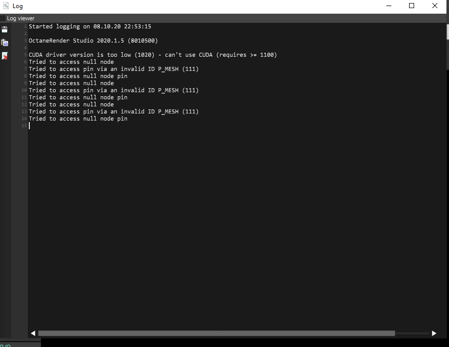

and lastly this is also my result, also on my octane log it says requires 1100.. it is weird what is 1100? I have a pretty good GPU and never had problem before

Posts: 10619
from 2020.1.5, you need an Nvidia driver greater than 451.00 that is based on CUDA 11.
You have 442.92 installed at the moment that is based on CUDA 10.2, so it is normal to receive that error message.
Please perform a clean installation of the latest Nvidia Studio driver, then download and run the new OctaneBench 2020.1.5, to check that everything is working correctly with the new driver:
https://render.otoy.com/downloads/a/61/ ... _5_win.zip
ciao Beppe
