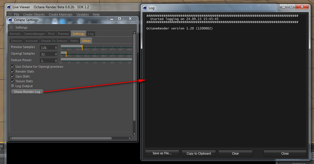

this is a renderer error which shows a cuda error. Can you show Octane Log window?
this is the octane render log. i think its not a problem with the cinema plugin, its a problem with my gtx 680 on the mac pro.
