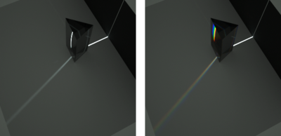

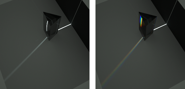

The following image compares a prism with index set to 1.3549, and the B parameter
to 0.0 (left) and 0.02 (right). The beam in the right image is split into colors and slightly
shifted down.

Is there any greater angle of the triangle (facing the light) which shows the out coming caustics at its best?
Win8 Pro 64bit ULT|Intel Core i7 3930K|3.20 GHz|32 GB RAM|GTX 590|UD5 2011 socket||2x TB HD||Master Cooler HAF X||Blender 2.6||Maya 2012||Octane|
roeland
Posts: 1826
I don't know the optimal angles for the triangle. One thing that will definitely improve the brightness of the caustic is tilting upwards the plane behind the prism, so the beam hits it at a less acute angle.
