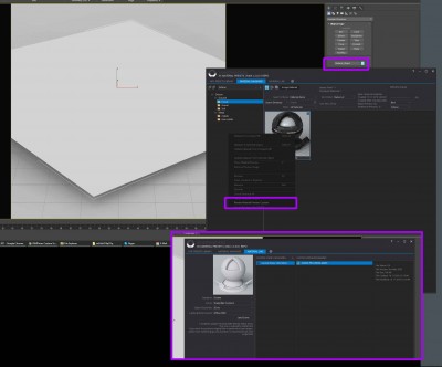

- Lab 80 cm does not render the preview, as custom scene. The plugin opens the scene but does not render.
- I opened a 40 cm scene, it works normally.
From this scene I deleted the objects and put a plane, now no longer renders either.

Are you set as Custom scene in Scenes manager? (Right click - context menu - set as custom scene).

samsue wrote:- Lab 80 cm does not render the preview, as custom scene. The plugin opens the scene but does not render.
Thank you for the pointers! I found bug in Custom Scene preview render (Octane) implementation and broken 80cm Octane file. Now fixed. Very soon will released new minor version with some more fixes.
