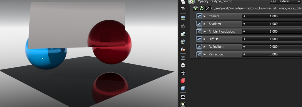

This is a super simple but very powerful Octane OSl texture shader,
kind of a "live compositing" node, allowing to precisely control the contribution of each ray type :
Plugged in the opacity of a material it allows to lower visibility or hide an object in reflection, refraction, AO ,shadow , diffuse or camera.
Or can be used for example, as "amount" attribute of a mix texture/ mix material node, or in emission texture, ect ...
raytype_contrib.zip
(410 Bytes) Downloaded 1816 times
> The blue sphere is not visible in reflection and refraction
Raytype_Contrib.orbx
(278.38 KiB) Downloaded 1262 times

fantome
Posts: 269
Joined: Wed Dec 16, 2015 3:38 pm
Thanks for the great shader it is very useful for reflection pass.
I think i have encounter a bug with the refraction.
- take a bunch of sphere with specular shader
- put an environment
- activate reflection and refraction pass
- plug the osl node in opacity
When you set :
- reflection to 0 in osl node -> it works you get the exact same thing without object reflections
- refraction to 0 in osl node -> it doesn't work, in fact the environment position is not the same and it is inverted
