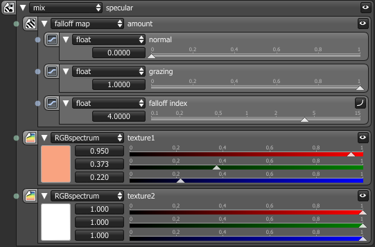

The recommended way to render gold is to set the IOR to 1.0, diffuse color to 0.0, and use a mix texture + falloff map for the glossy color. The falloff map will simulate the Fresnel effect on the material.
There is a material in LiveDB (Materials » Non-Organic » Metal » Colored metal) containing this setup. Materials like this will look like the teapot on the right.
