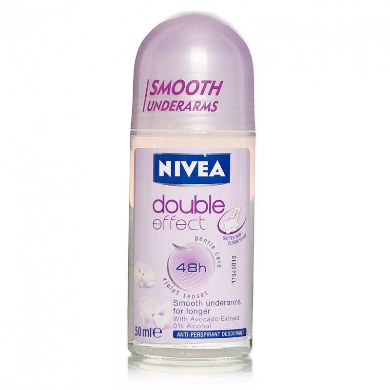

Hi, this is my first time using octane for a tv add here in Chile, and im still trying to figure some things abouth the materials. My problem is simple, but i dont know how to resolve in octane.
I need to create a material for a deodorant, specular material with a glossy for the label , like the screenshot:
I tryed to use the mix material but i can get the material to work:
If someone can explain to me how to generate the material please :(
Thanks!

you need a map with the label black and the glass white attached to the mix node in order to set where are the different materials, otherwise the two materials are mixed together ;)
