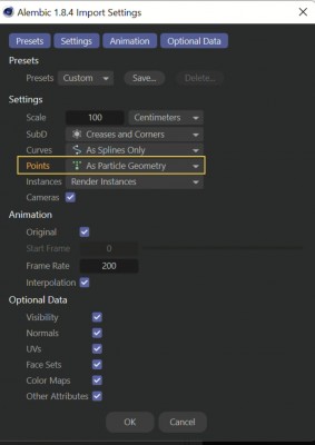

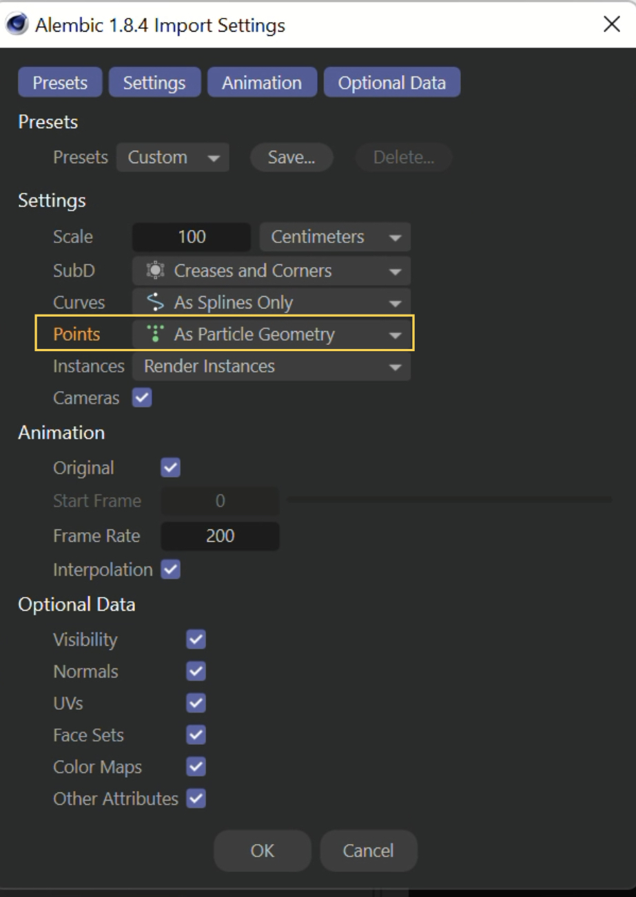

Hi Andrea,
try to use this alternative setup.
Merge the Alembic file and set the Points As Particle Geometry, insted of As Polygon Object.

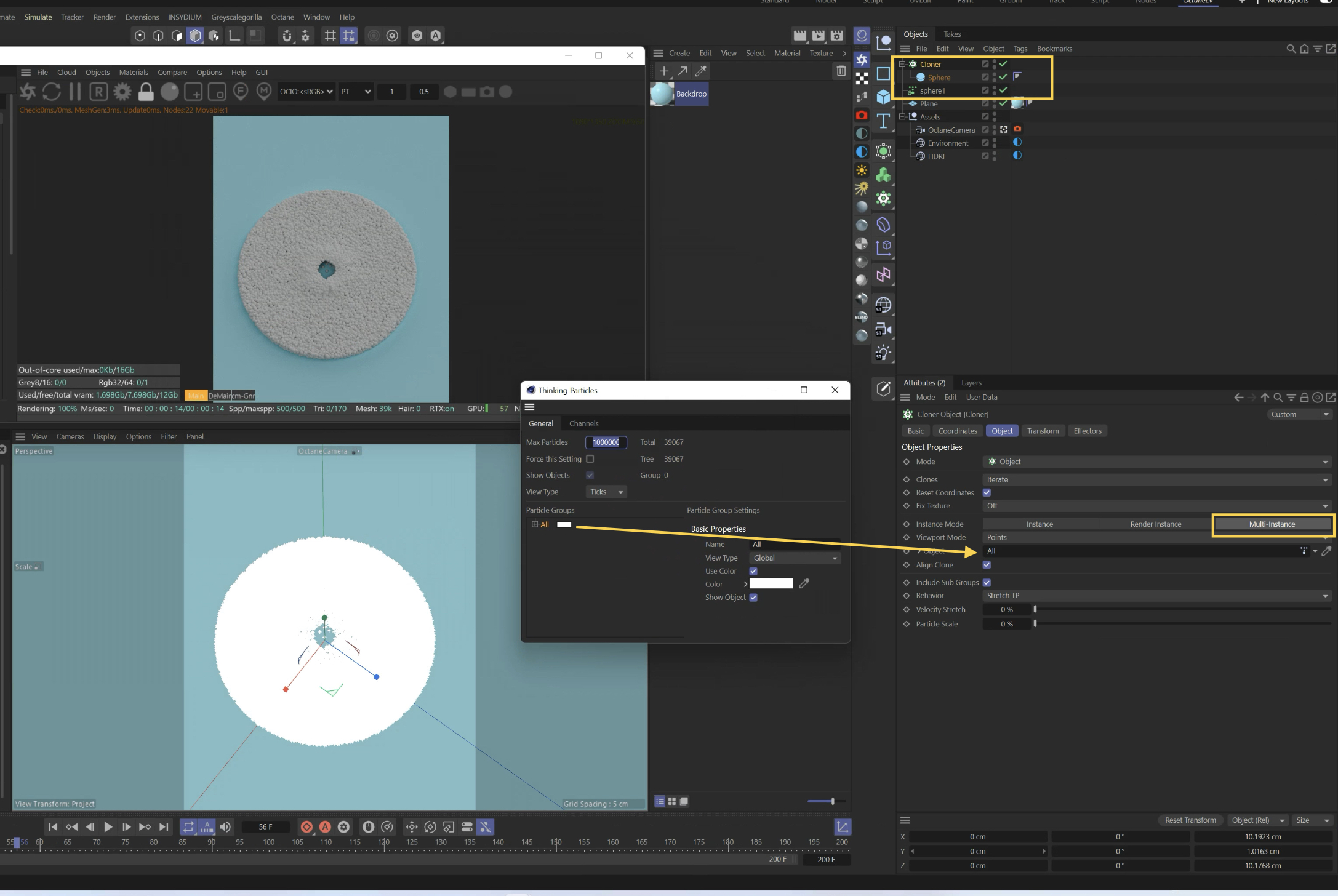

Then go to menu Simulation/Thinking Particles/TP Settings and drag and drop the All Particle Groups in the Object source of a MoGraph Cloner, in Multi Instance mode:
