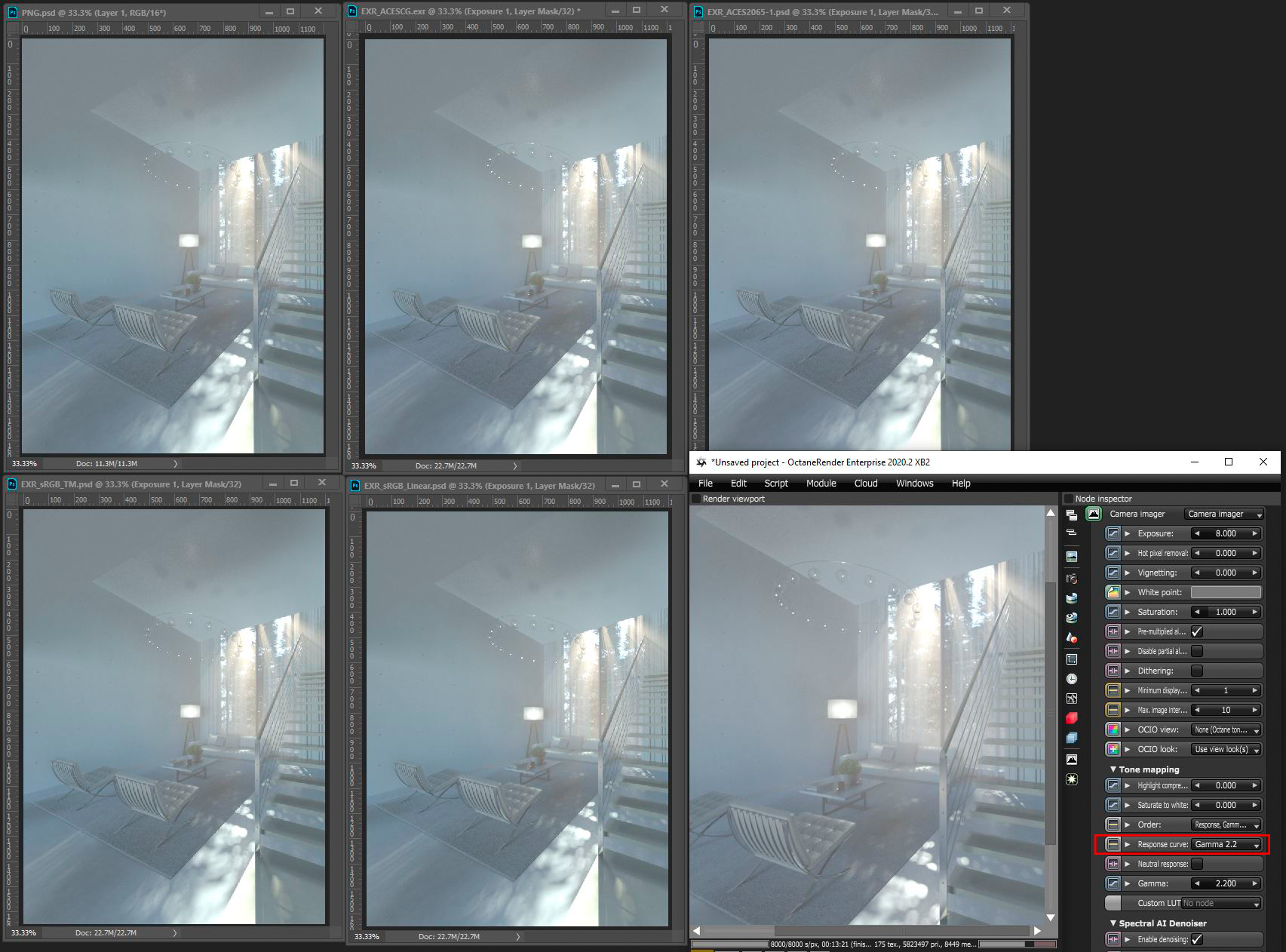

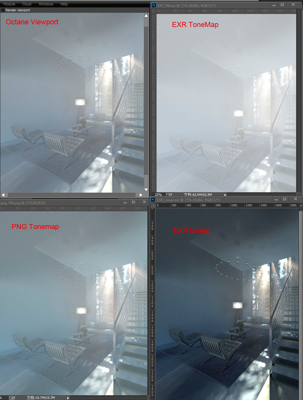

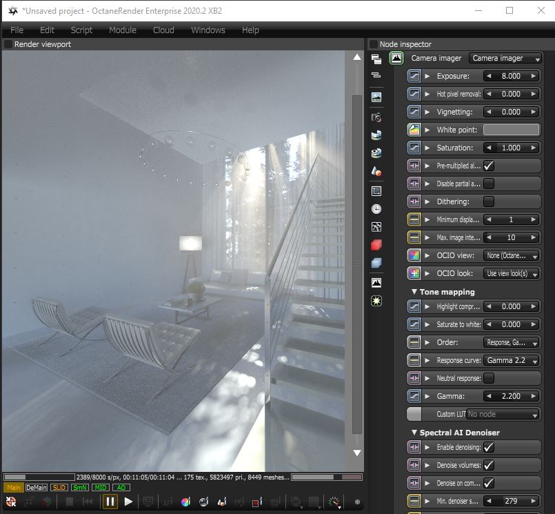

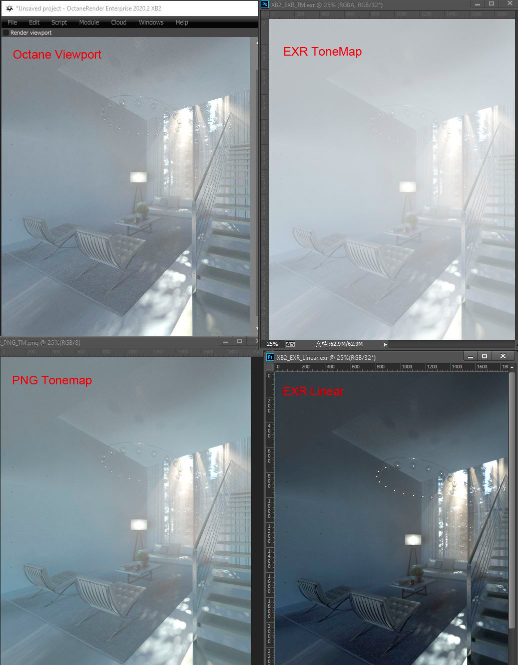

Probably let you guys see what I see, may helps...
A quick testing scene is like this
I did it in XB1 either, when export what I get is like this:
Now I was expecting things could be better in XB2,
Anything has changed?
It is fraustrated.the gamma issue is ignored which makes huge different

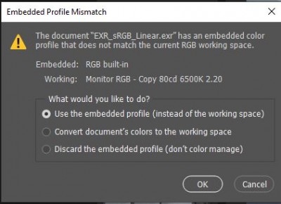

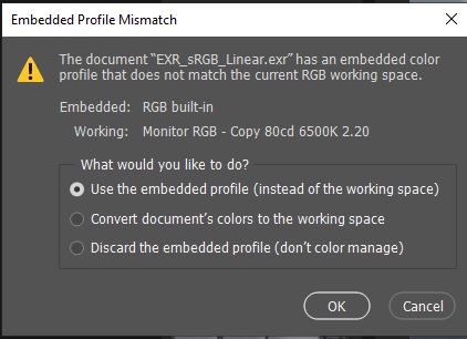

when opening in photoshop, all the image is using octane's by default "builtin RGB profile" to import(see below snapshot),
if an image is attached a color profile, means it is color managed, if this color management is in the right way,
all the image should be looking the same...
non of the exports is prcisely reflecting the viewport's color
BTW the exr in aces are also not in a right way.
I can fix this mannually, the question is can Otoy do it correct directly.

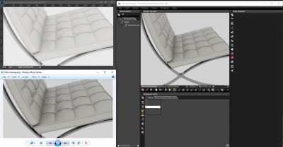

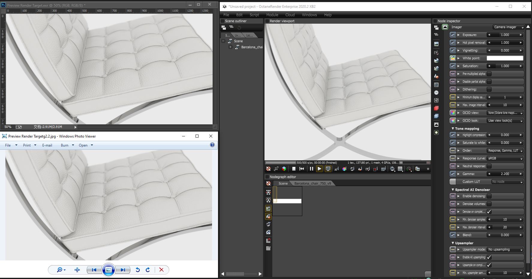

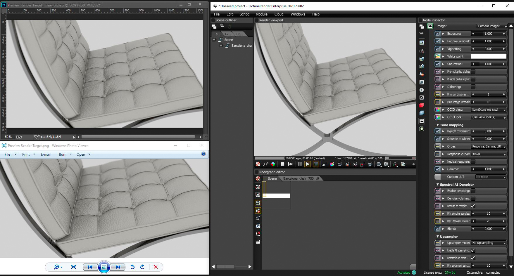

Correct color management make a image looking the same in different apps...
Or Like this
the original is like this:

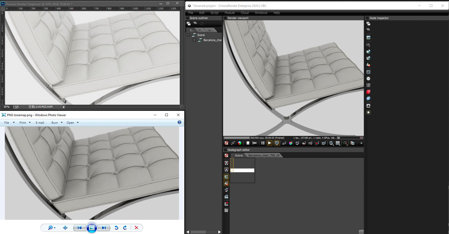

As a result of color management, manually attaching proper color profiles, and manually apply the gamma value, then all different exports can finally meet the original viewport looking,
My question is Why we can not get these directly?

The change to add the ability to export a scene-linear EXR file including the tone mapping settings (and a few related changes) just didn't make it into XB2, but it will be in XB3. The option is called "Force tone mapping"; in this case you would use it in conjunction with the default color space for EXR export (linear sRGB).
To explain the differences in those screenshots:
  • There appears to be a difference in saturation between the XB1 and XB2 screenshots. I guess this is a change in the scene? Nothing should have changed so let me know if it's the exact same scene.
  • The EXR ToneMap image is too bright due to Photoshop interpreting sRGB as linear sRGB (or equally, Octane passing sRGB off as linear sRGB on export), as we discussed before. XB3 fixes this by never saving a non-linear color space to an EXR file.
  • The EXR Linear image is darker than the Octane Viewport due to using Photoshop's tone mapping instead of Octane's tone mapping. Neither one is objectively "right"; there are just many different methods of preparing a scene-linear image for display (this is something that OCIO can address, if used consistently across all applications).
  • The difference between the PNG Tonemap image and the Octane Viewport image is interesting, and not something I can reproduce myself. I would guess that it's due to different display color management between Octane and Photoshop. Are you using the same display color profile in both applications?
