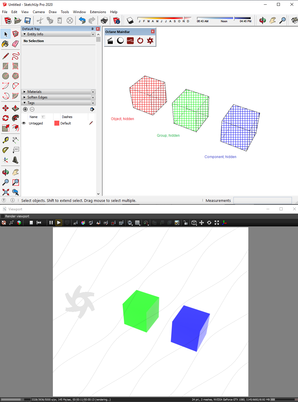

The Octane Sketchup plugin does not respect hidden groups and components, as shown:
All three cubes are hidden and should not be rendered by Octane.
Using: OctaneRender_demo_2021.1_v1.0_for_SketchUp_2020_win

Hi ncasedesign,
Thank you so much for reporting this issue.
We are able to replicate it on our end and reported to our dev.
We hope to fix it in future releases.
As a workaround, please use the SU Layer to hide the geometry!
