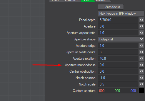

BTW i think this is typo error here in Universal Camera DOF Tab?
Says "Apperture Roundedness" Shouldnt it be "Roundness", it has extra "de"

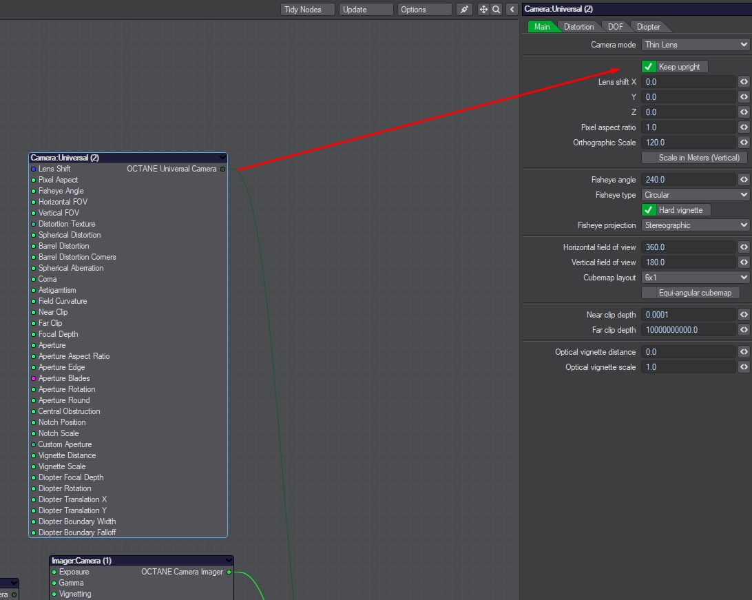

Also please check Universal Camera option called "Keep Upright", That should be same as "Perspective correction" at regular ThinLens camera (Why name change ? OTOY ?) but for some reason when it's ON it ignores Pitch channel rotations completely which is wrong 'coz then it can't be matched to ThinLens camera or LW shift Camera (arch-Viz camera) so working with that option in OGL is impossible to match angles.

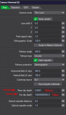

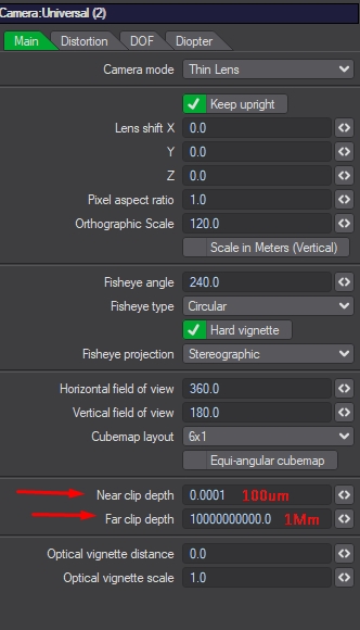

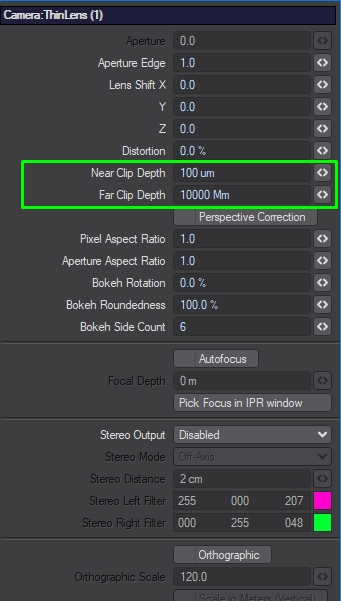

And One more for Universal camera,
Please bring back same Units in the Near and Far clip depth. Currently there is no units while regular ThinLens has them nicely in units (meters).
All the distance inputs should celarly show mm, cm, m, km, units and not be 1000000000.0 or 0000.1 etc.. It's much nicer and easier to type in 1000km than 100000000.0 or 100um than 0.00001
