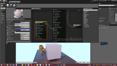

I giive the medium material to the cube, but it still show as a diffuse material.

Thank you so much,and your explain for making a volume material is so clear .But it doesn't work after i follow your way. the material still show as a diffuse material.

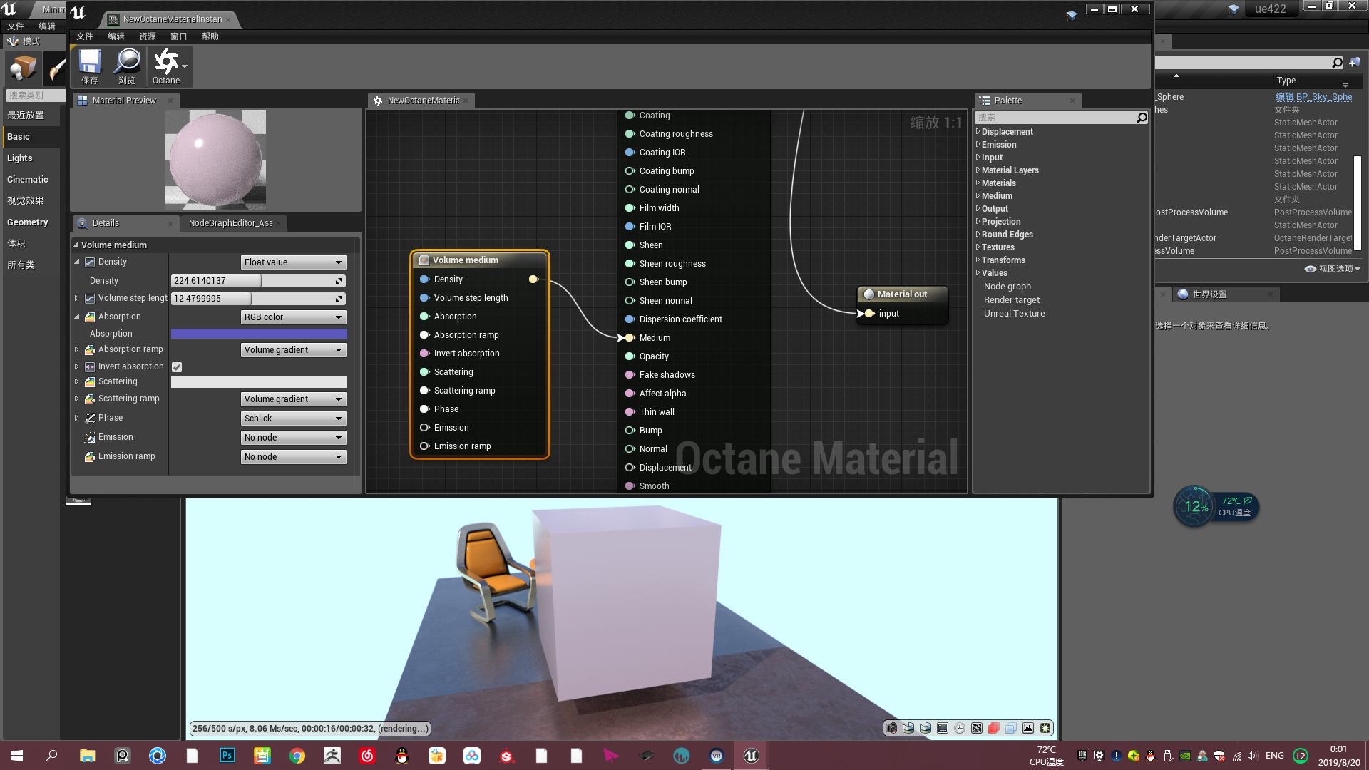

Thanks a lot. But there is still question.ChrisHekman wrote:Sorry there are some extra steps.
- Reduce the Dielectic IOR to 1 (Same are air)
- Albedo and metal to 0
- Transmission to 1
Or use a specualar material with an Index of refraction of 1 and a medium node.
I reduce the Dielectic IOR and metal, but there is no option to reduce color and Transmission to 1, i just can choose the node of them.
But i made the fog with specualar material successful.

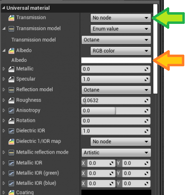

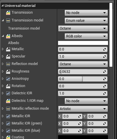

For in the future, you can change the transmission node by attaching an Grayscale or RGB Color node to it.
I have also included an image that shows where to click to change the transmission and the albedo.
The transmission can be changed by clicking the dropdown menu button the green arrow is pointing at. Select the RGB Color node. Now you should have a white transmission.
The albedo color can be changed by clicking the white color bar the orange arrow is pointing at. You should get a color wheel popup that allows you to select the color.

Thanks a lot. But it still doesnt show correctly ,maybe i didnt reduce the "air" to 1. I dont know what the "air" option means .ChrisHekman wrote:Good to hear.
