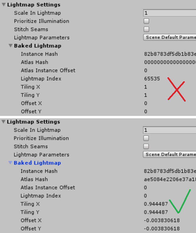

This looks correct.
Couple of possible issues
- "Baked Lightmap" atlas info was not saved to scene.
You can check this by selecting a static MeshRenderer. In the inspector check Lightmap Settings -> Baked Lightmap
If the atlas is 65535 that means it did not save its atlas info. - Textures are not found by the assetdatabase and the lightmapsettings are filled by null textures
- Script start function is not called when going into play mode.
