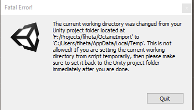

I have scene setup in Octane Standalone 3.07 that I'm exporting as ORBX and importing to Unity. But every time I hit render in the PBR Render Target to initialize the scene, I get the pop-up error from Unity in the attachment.
Unity completely closes after closing the pop-up.
I can see however that the placeholder volume(grey box) gets placed into the scene, and it even renders the frame in the viewport. Sometimes Unitys log shows errors about invalid AABB values, and other times it's "access violation".

What's the location of your imported/exported ORBX files? Are they within your Unity project directory?

Anybody have a solution for this? I am getting the same error when importing on ORBX exported from OctaneRender Studio 4.04 into Unity 2018.1.3f1 as well as when rendering a loaded ORBX in Unity project directory. The error dialogue appears when the importing of textures start. I've tried both importing ORBX in and outside of my Unity project directory.
