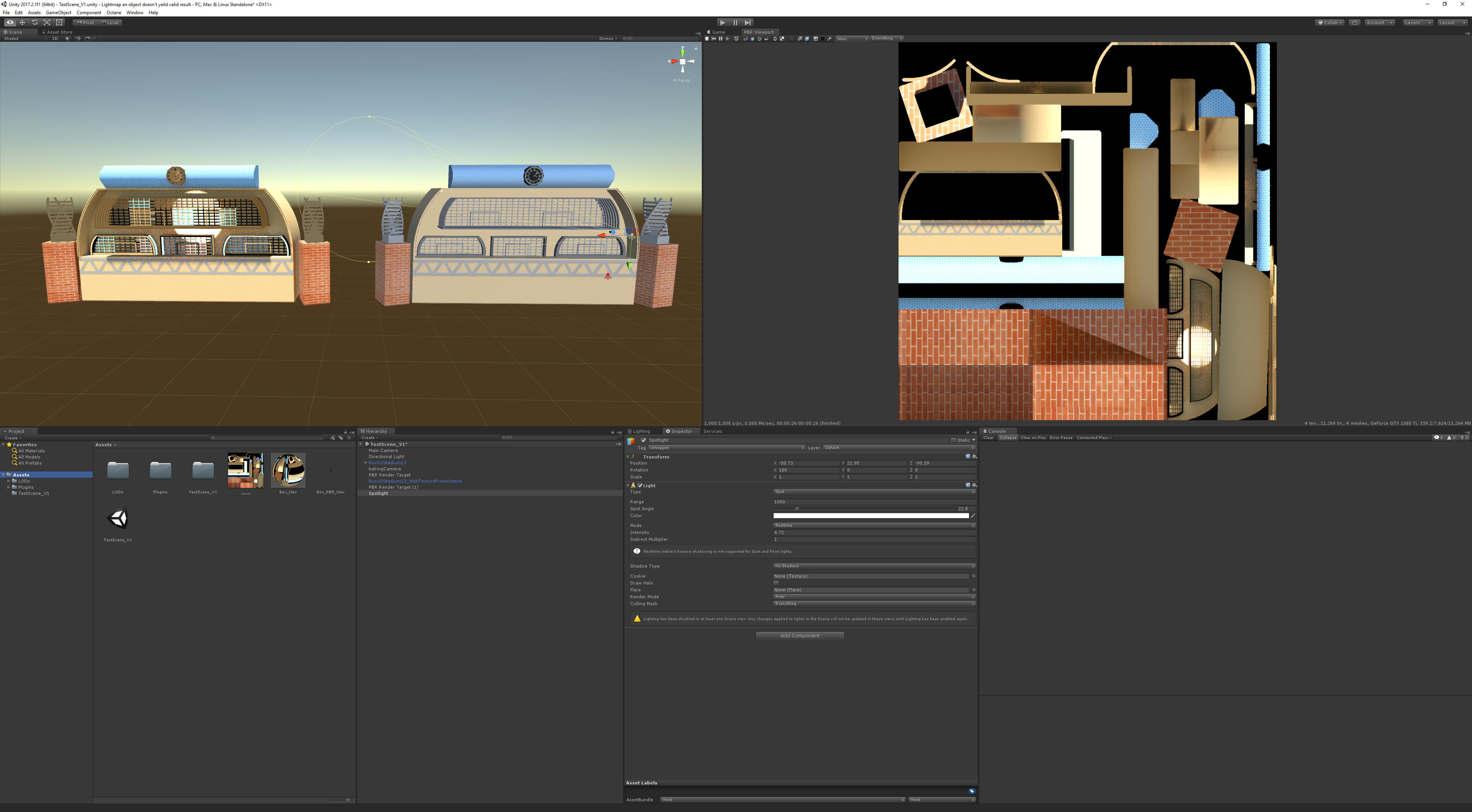

Xhed
Posts: 239
Joined: Wed Jul 10, 2013 10:27 pm
Location: Breda, The Netherlands
With the exception of the atlas being off for applying the baking result, I have the result of the spotlight in the map when I try to follow your steps. It might have something to do with the settings I used for the spotlight though.
Lightmap result
Lightmap result
- Rick
