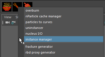

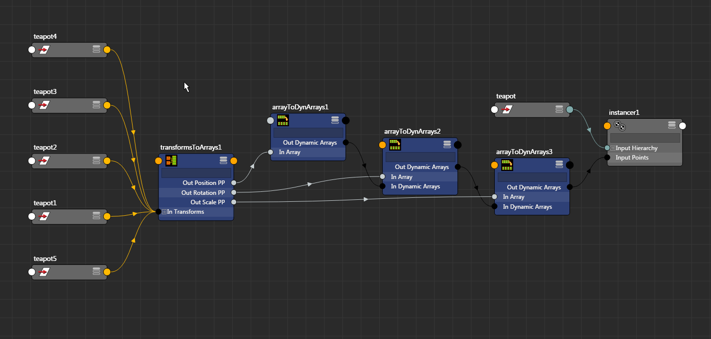

Converting instance to instancer is done like this:

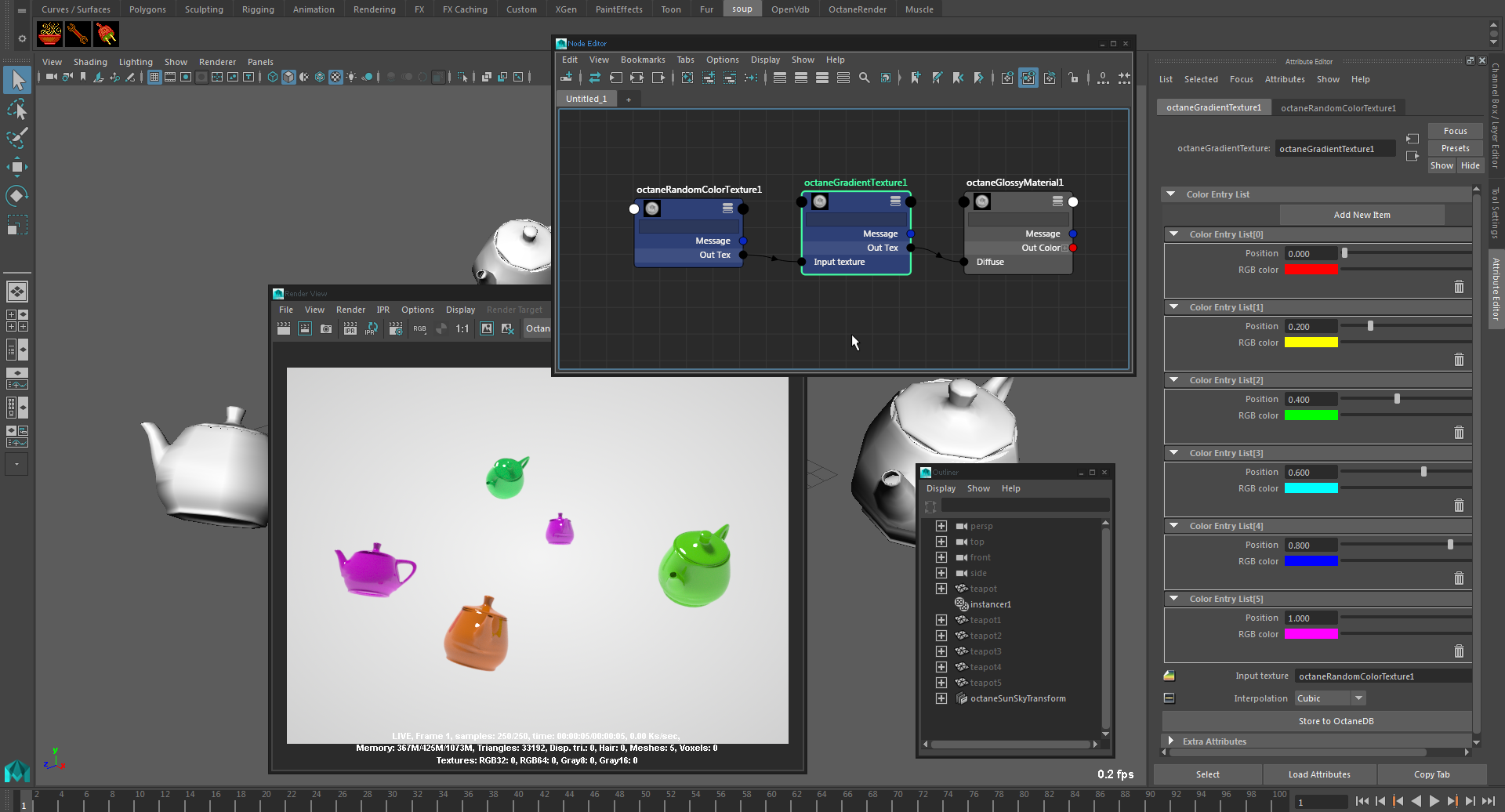

Then as now we are using an instancer instead of regular instance the Octane randomColor node just works:
