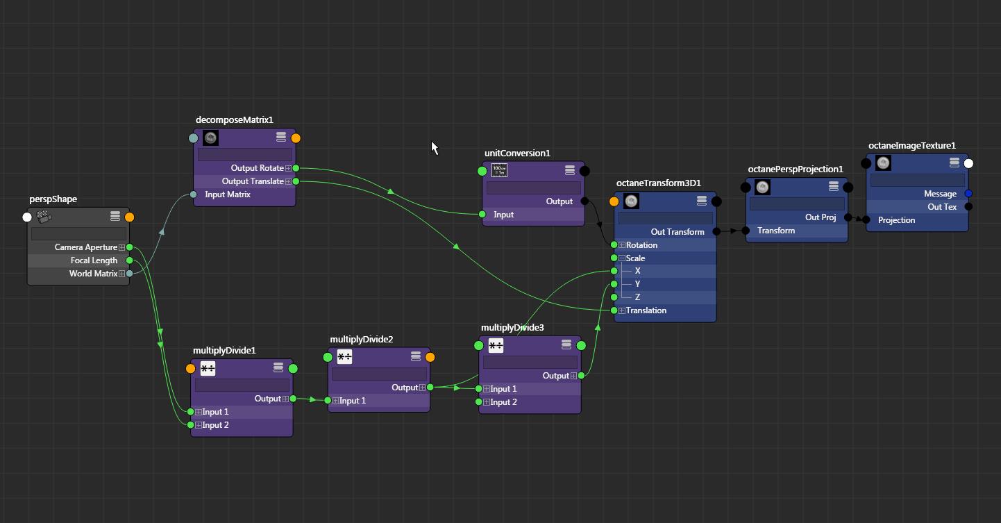

As some may have noticed, the "camera mapped" feature in ImageTexture nodes is broken since it exists in Octane V2,
it only works with "Global" geometry type and doesn't support render layer ("Global" geometry always use the render layer 1, whatever ID is selected)
EDIT: camera mapped feature is now fixed in V3 and last V2 plugin, but the script is still useful for advanced work.
So, here is a python script to project any Image or procedural texture from the current camera:
OctaneCameraProj_0.1.py.zip
(831 Bytes) Downloaded 486 times
Edit: v 0.2 added more nodes for Octane scale factor and Maya units.
OctaneCameraProj_0.2.py.zip
(945 Bytes) Downloaded 451 times
Edit: v 0.3 updated for recent octane plugin, indice of world space coordinate have changed from 0 to 1.
OctaneCameraProj_0.3.py.zip
(997 Bytes) Downloaded 447 times
As usual to use the script, run it from a script editor python tab or from shelf button.
It create this network between current camera and all selected texture nodes:
The resulting projection is the same as the "camera mapped" feature, but works with any geometry types,
if for some reason you need to "bake" the projection,
just delete the decomposeMatrix and the multiplyDivide nodes.

	for node in nodes:
		node_e = cmd.createNode("octanePerspProjection")
		node_f = cmd.createNode("octaneTransform3D")
		cmd.connectAttr(node_e+".outProj", node+".Projection", f=True)
		cmd.connectAttr(node_f+".outTransform", node_e+".Transform")
		cmd.connectAttr(node_g+".output", node_f+".Translation")
		cmd.connectAttr(node_a+".outputRotate", node_f+".Rotation")
		cmd.connectAttr(node_c+".outputX", node_f+".ScaleX")
		cmd.connectAttr(node_d+".outputX", node_f+".ScaleY")
		cmd.setAttr(node_e+".PosType", 1)
		cmd.setAttr(node_f+".ScaleZ", -1)
		cmd.setAttr(node_f+".RotationOrder", 5)

Jolbertoquini wrote:Awesome script Calus,
But is a small problem when you use the scale option 0.01 so maya provide 1 maya unit 1cm really standard on the industry the script doesn't work. I have to add manually a extra multiply node to compensate but the result still weird.
Best
JO
Right, I only considered default settings previously.
I edited the first post with a new version of the script,
it should work correctly now with any Octane scale factor or Maya Unit, even if they are changed later.
Thanks for testing !
