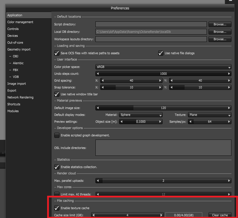

Two solutions that may help.
- As Blender uses the same cache folder as StandAlone, could you please check the texture cache size in the SA's preferences? Just in case the files were removed due to the limitations.
- In the next release, we'll introduce a setting about the "Octane texture cache folder" to allow users to change the texture cache folder. That would probably help.
