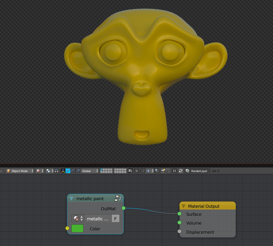

I'm curious if material node groups are supposed to work or if they're not supported by the plugin.
As far as I can tell, I can make a group in the node editor encompassing the whole material node graph no problem but as soon as I try connecting any inputs or outputs from outside the group I get the standard white material, ungroup and it's fine though.

Exposed shader values like color does not work outside group. See attached file.

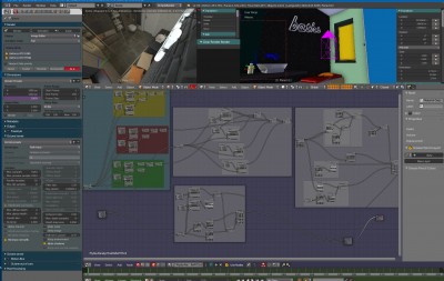

could you write when Node Group Exposed Parameters will work with Octane Nodes?
It is very hard to create own shaders without this capability especially when creating very complex materials ( look at the picture )
Please, tell when.
Thanks!

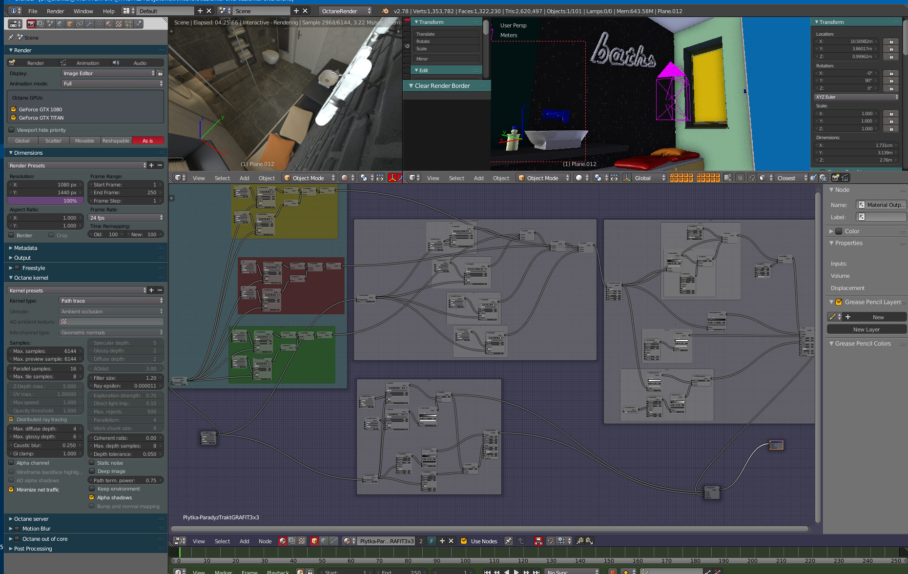

Please, tell when.
Thanks!

Latest release (11.24) has it working! Thanks Jim Star!
