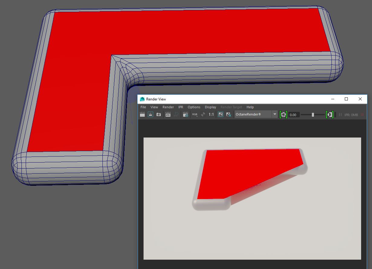

Working with archviz, I have 3 big problems with Octane (besides the non-mayan plugs) that I wish for improvement:
1. maya like triangulation: the need to triangulate my geometry every time I'll do a render then revert the triangulation to continue working on clean geometry is a hassle.

Not sure what is your use-case here (Nurbs, triangulation winding order, smooth mesh preview, subdiv crease ?)ivankio wrote: 1. maya like triangulation: the need to triangulate my geometry every time I'll do a render then revert the triangulation to continue working on clean geometry is a hassle.
But actually for every type of geometry, the Maya tesselation is very easily accessible for plugins,
and I never understood either, why it was not used by the octane plugin.
E.G : For smooth preview, the Maya tesselation is just the outSmoothMesh attribute of the mesh node...

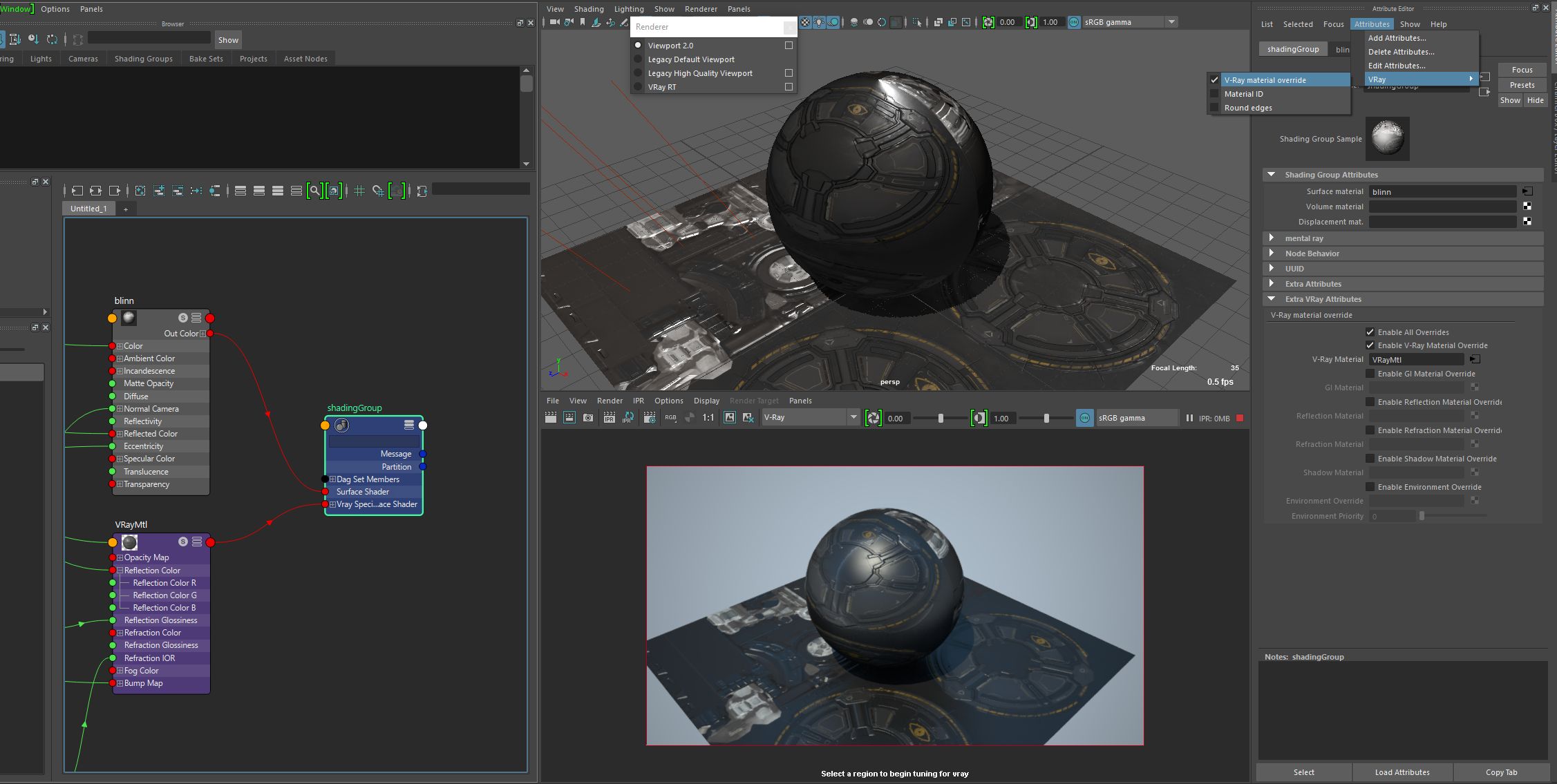

viewtopic.php?f=28&t=52995ivankio wrote: 2. viewport material appearance when working and making changes (specially transparency for windows)
In the meantime, you can use this script.
It adds to the octane materials a "hardware Shader" attribute where you can plug a Maya shader to override the display in viewport 2.0.
(Though, it doesn't solve your issue for export)

The triangulation of concave polygons. I have lots of those on walls and some furniture.

Right, concave n-gon are not supported by the Octane renderer.
The plugin use its internal obj exporter, not a very smart exporter ...
(Ngon are not tesselated)
But actually when the plugin use alembic to export geometry, concave ngon are supported !!
So for rendering, maybe the plugin should also use his alembic exporter instead of his obj exporter.
This would solve the ngon issue but also subdiv with crease
Anyway there's a lot of of room for improvement, I bet Kai will make it a lot smarter.
