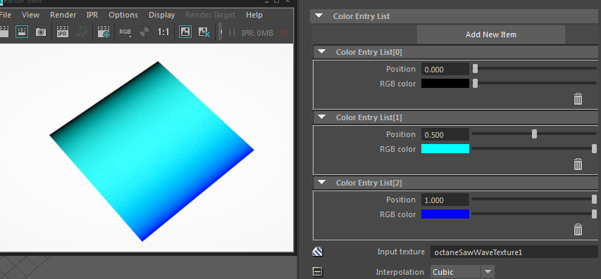

To reproduce the bug:
1/ Create a gradient texture node, create several color entry, keep the first one black and position 0 :

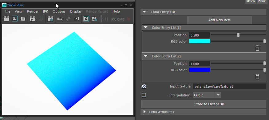

2/ Save the scene and open it again :
3/ The first color entry disappeared !
The same bug happens with Volume Color Gradient node.
