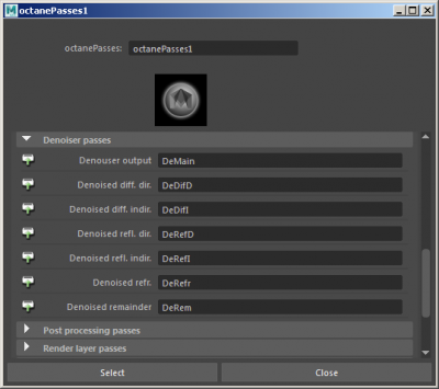

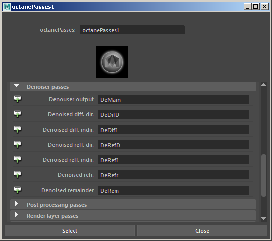

I tested more about the denoiser we have some issues there. the 1st problem is to work with denoiser on Ipr to update while sampling we deactivate the "denoiser on completion", if this tag is off the batch render doesn't render out the output., but if I activate and send to render again is working.
We have one other problem which is the output render is wrong Denoiser result are coming on different folders, but also with alpha activated! basically is complete ignore the settings we have on. I checked on the standalone aswell and is correct there is setting issue from the plug.
If I use the ipr preview is fine , but viewport octane preview is actually wrong as the render has premultiply alpha without being activated on the settings same result as the batch render.
One other point is naming is wrong aswell should be "_DeMain" and right now is set "_d_out" ?? also the render is on different folder not with the main beauty render.
Hope you understand the errors.

Hi Jo,
Thank you so much for the reports.
The first issue has been resolved in our internal build.
We are investigating the issue number 2 & 3. And for the last one, it seems the prefix has to be one letter plus underscore. So, in the next release, the denoise pass would be d_main.
cheers
