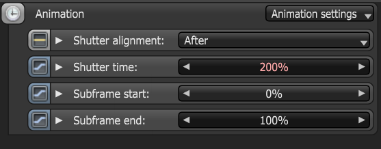

Let's talk frankly of the Motion-blur in the Maya plugin: it has always been half-broken at different levels,
was completely broken in early V3, so the "compatibility reason" argument is very weak,
and even so, it's not that hard to overall a proper implementation of Octane motion-blur while keeping compatibility,
Motion-blur UI in Maya must respect Octane core implementation first,
with the exact same settings names using the exact same units
Shutter Time use percentage per frame not seconds !!!!
Yes we already have the same attribute MB shutter but not used for InternalMB...
subframe starts and end are also expressed in percentage and completely missing in the Maya plugin,
If you don't understand the purpose of these 2 last settings, still you must implement them , Standalone team and advanced users know how to use them !!
Also motion-blur is supposed to be off when Shutter time =0 , so doesn't need a OFF mode.

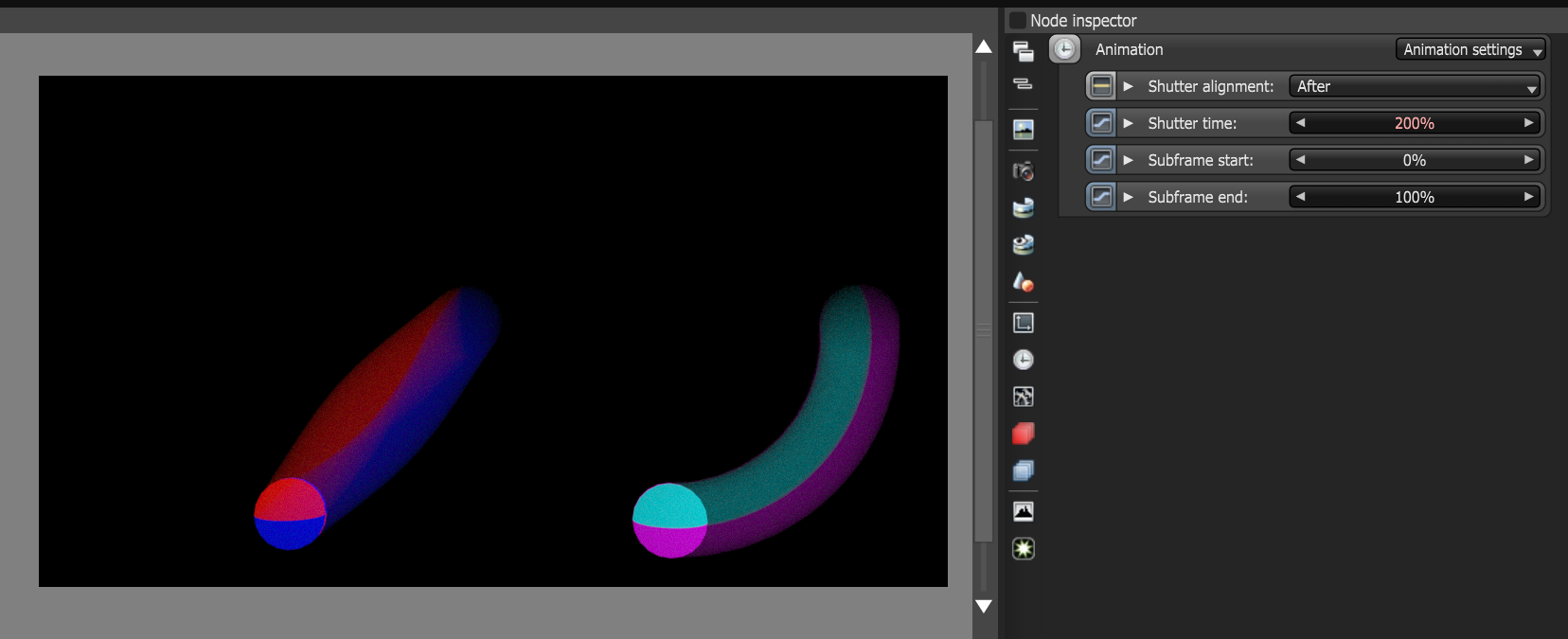

One more attributes is needed in Maya but not present in Standalone because this is not a rendering feature, but a 3D application standard feature:
MB time samples, this is how Maya is sampling geometry at different subframe to extract different state of the geometry at different time.
This different geometry samples (at least 2) are used by Octane to interpolate the Motion Blur, more samples we have, more precise is the motion blur.
In standalone you can render motion-blur with objects having different subframe sampling...
MBsubframePerObject.orbx
rotation animation of 2 bicolor ball, left one is the animation as is maya at 25FPS and render as in Maya lack of time samples! the right Shpere is the same but exported at 250 FPS to add time samples, the standalone scene is at 25 FPS and support motion blur for right sphere with 10 subframe per frame and left sphere which has only 2 sample per frame as this is the limit in Internal motion blur.
(157.42 KiB) Downloaded 307 times
MotionBlurSubSamples.zip
Maya scene with the sphere animation.
(13.22 KiB) Downloaded 300 times
So keep in mind for the future that Octane support automatically per geometry custom time sampled ,
MB Time samples have to be implemented this way in Maya:
- one global setting defaulting to minimum (2 samples)
- at mesh levels an attributes to override the number of samples
We already have this setting in Maya, it's called number of MB time samples.
It just need to be enabled for internal Motion Blur and make it work with IPR, also make it default to 2 (not 10).
Obviously Internal MB mode and Subframe MB mode settings don't have to be the same internally but that's how they must appear to the user, because they are technically the sames settings.
