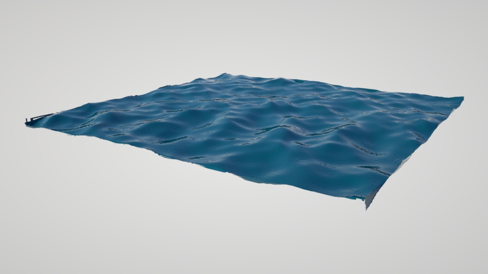

by the way here is a sample scene for some of Maya texture baking feature bugs,
this is using a Maya ocean texture in octane displacement,
just scrub the timeline Maya should crash.
if you can run IPR you can see the problem on border edges of the displaced surface (missing fill option I guess),
also obviously the texture is baked to 8 bit so makes stairs in displacement.
MayaOceanTextur.zip
(13.6 KiB) Downloaded 271 times
