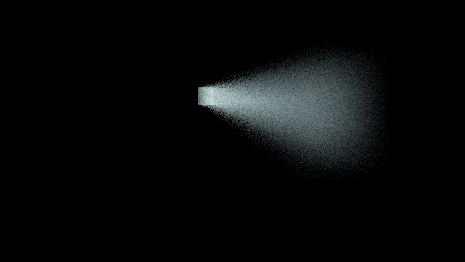

light fog cannot work with a matte object ,this is a bug?
v2 works well ;)

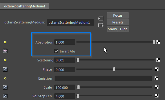

I guess maybe your problem comes from the difference between V2 and V3 scattering medium,
as there is a "inverse absorption" attribute in V3 enabled by default, you might have an inverted absorption compared to V2 ?
If this is is the problem, you just need to change absorption from 1 to 0, or disable the "invert absorption" checkbox.

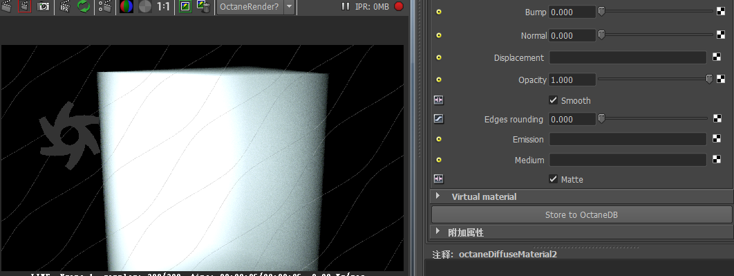

I know this about Invert Abs,I found matte poly has no shadow at Kernel alpha shadow,this is why light fog no shadow effect ;)

I know this about Invert Abs,I found matte poly has no shadow at Kernel alpha shadow,this is why light fog no shadow effect ,so it is a bug ;)

renmaxhb wrote:I found matte poly has no shadow at Kernel alpha shadow,this is why light fog no shadow effect ,so it is a bug ;)
Still not sure where I'm supposed to see this bug in your example scene.
Can you show the difference between the result you have with V2 and V3 ?
Because when I render your scene, the plane have a shadow and let the light only go trough the hole, as supposed:

set poly with hole materier to matte
calus
Posts: 1308
Location: Paris
renmaxhb wrote: set poly with hole materier to matte
Ok I see the problem and the difference of behavior between V2 and V3, thanks Renmaxhb :)
If it's a bug it's not in the plugin, it's in octane core (same problem in standalone),
It might also be that the bug is the behavior of V2 and it was fixed or maybe this have been changed on purpose for another reason (but I don't think so) .
I have asked in standalone Section:
viewtopic.php?f=24&t=58323&p=301016#p301016
