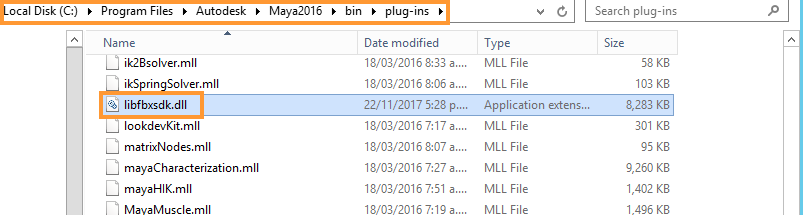

zurakan wrote:I just test in maya 2016
It cant not load plugin !!!
Hi Zurakan,
Can you please cut/paste the `libfbxsdk.dll` from [c:\programfiles\Autodesk\maya2016\bin\plug-ins] to [c:\programfiles\Autodesk\maya2016\bin] folder then try loading Octane Maya 2016?

zurakan
Posts: 44
Joined: Fri Sep 27, 2013 7:13 am
Hi Zurakan,
It work Thank so much
