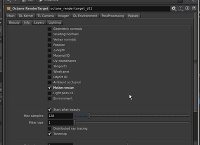

hello,
i create sphere (polysphere)
with attribvop i add velocity,
when i rendering i dont
see motion blur. :shock: :shock: :shock:
it works with camera motion blur, and if i do animation key-frames on sphere ...
but not from attribute. i tried to promote attr from point to vertex.
what i am doing wrong? :oops:

juanjgon
Posts: 8867
Location: Spain
The problem is that you have the "Motion vector" pass enabled in the render target. If you enable the motion vector pass, the beauty passes are not blurred to allow apply the MB effect in post.
If you disable it, all should work fine.
-Juanjo
valk
Posts: 10
Joined: Thu Apr 30, 2015 10:33 pm
oh ..i see ..
thanks! :oops:
