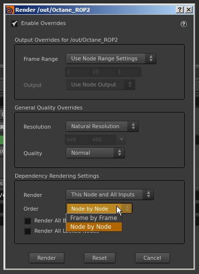

I have found the problem. By default the render buttons render the multiple ROPs frame by frame, something that is impossible in Octane due to the ROP node architecture (you can't have more than one scene initialized at the same time).
The solution is easy: you can render multiple ROPs (in a chain or with the merge node) if you open the "Controls" panel, select the render order "Node by Node" and press "Render".

You are right. I have fixed a problem perhaps related to this problem ... but anyway the main problem is that it seems a limitation of Houdini. I am testing a scene rendering two chained Mantra ROP nodes, one with a 5 frames range and other with 10 frames range, and both are rendered using the 10 frames range. If use the merge node I also get the same behavior.
Can you please check in your system if Mantra has the same problem, to be sure? I am testing H15.0.393

Sorry, it was my mistake. When you set Frame Range to (Strict) on every ROP node and then set "Node by Node" in Merge, then everything renders correct.
Hooray, problem solved! Thank you!

Stassius wrote:Sorry, it was my mistake. When you set Frame Range to (Strict) on every ROP node and then set "Node by Node" in Merge, then everything renders correct.
Ahh, thanks. Yes, this is the correct workflow to render multiple ROP nodes.
