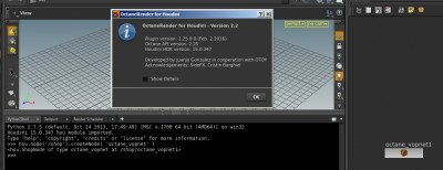

I have not here the same version that you are using, but with H15.0.347 and the plugin 2.25.0.0 this python command seems to work fine.
Do you have this problem if you type the command in the python console in an empty scene, like in the attached image? I can install the Houdini and plugin versions that you have to try to reproduce it.
