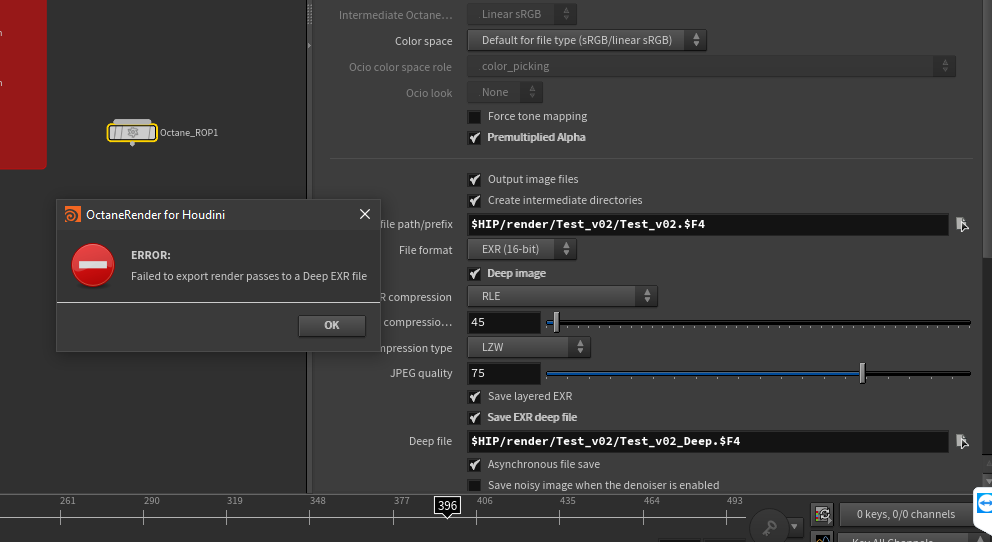

Hello,
Trying to render Deep Image and get a fail on the farm with :
2024-03-19 21:29:50: 0: STDOUT: 21:29:49 INFOR: [save image] -------- Saving the Deep EXR "/mnt/Projects/ElectricLensCo/SPS/JT24/Houdini/render/Test_v02/Test_v02.0001.exr" file
2024-03-19 21:29:50: 0: STDOUT: [Octane] 21:29:49 INFOR: [save image] -------- Saving the Deep EXR "/mnt/Projects/ElectricLensCo/SPS/JT24/Houdini/render/Test_v02/Test_v02.0001.exr" file
2024-03-19 21:29:50: 0: STDOUT: *** OCTANE API ERROR: Deep image is not enabled.
2024-03-19 21:29:50: 0: STDOUT: *** OCTANE API ERROR: failed to tonemap the render passes
2024-03-19 21:29:50: 0: STDOUT: *** OCTANE API ERROR: failed to save deep EXR
2024-03-19 21:29:50: 0: STDOUT: *** OCTANE API INFO: ERROR: failed to export render passes to a Deep EXR file
2024-03-19 21:29:50: 0: STDOUT: 21:29:49 INFOR: [core] -------------- ROP node render, time 0.03
GUI equivalent shows :
Using Windows and Linux on this build. I noticed a Deep Image fix in earlier builds but it seems to not work in this build. I'll test a few more work arounds to see what can be done.

Hi Renbry,
Thanks for the info, are you getting the same issue with 2023.1.2.2?
viewtopic.php?f=102&t=83227
Renbry
Posts: 43
Joined: Fri Nov 23, 2018 9:09 am
Apologies - I meant to do a follow up.
I didn't realise I needed to have Deep Image enabled on the Render Target. I'm new to Deep in Octane.
I guess the error popup could help clarify that Deep isn't enabled in the Render Target whereas it just say's it's 'not on' which confused me when I was playing in the ROP.
Thanks!
