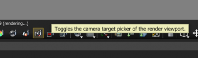

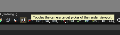

As for the orbit around object, there is a specific tool in standalone to help with this as far as I know, (Camera Target Picker) but also if you set Target on the camera to 0.0.0 then it should orbit at world center.
