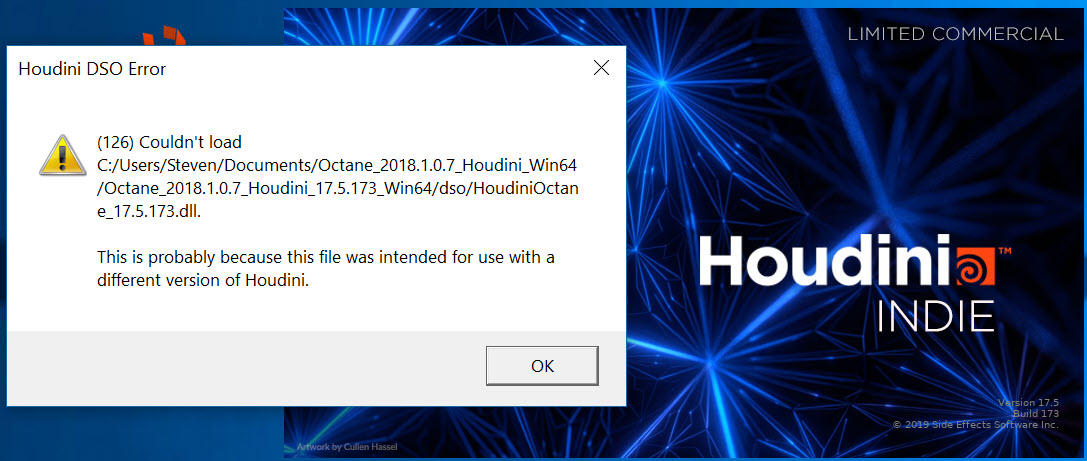

sfshook
Posts: 8
Joined: Fri May 06, 2016 3:27 pm
I got the error message when I started Houdini.
Thank you,
Steve
dearthman
Posts: 12
Joined: Fri Nov 18, 2016 6:42 pm
sfshook wrote:Hi,
Thank you,
Steve
Same error for me as well.
juanjgon
Posts: 8867
Location: Spain
This seems a problem with the houdini.env file PATH variable. Can you please attach your houdini.env files to check them here? You should also check if the Octane 2018.1 Standalone works fine in your system.

dearthman
Posts: 12
Hi Juanjo! Thanks for the prompt response. You are right I missed the /bin addition to one of the .env file paths. Seems to work fine now!
sfshook
Posts: 8
Hi, Juanjgon,
I have attached the env file.
Thank you,
Steve
For some reason I can't see if the file uploaded, it is very short.
#Octane In
HOUDINI_DSO_ERROR = 2
PATH = "$PATH;"C:\Users\Steven\Documents\Octane_2018.1.0.7_Houdini_Win64\Octane_2018.1.0.7_Houdini_17.5.173_Win64\bin;$PATH"
HOUDINI_PATH ="C:\Users\Steven\Documents\Octane_2018.1.0.7_Houdini_Win64\Octane_2018.1.0.7_Houdini_17.5.173_Win64;&"
#Octane_2018 Out
juanjgon
Posts: 8867
Location: Spain
sfshook wrote:Hi, Juanjgon,
Can you please remove the first "$PATH" string in the PATH variable?
Code: Select all
PATH = "C:\Users\Steven\Documents\Octane_2018.1.0.7_Houdini_Win64\Octane_2018.1.0.7_Houdini_17.5.173_Win64\bin;$PATH"
Thanks,
-Juanjo
sfshook
Posts: 8
Hi Juanjgon,
I change the env file to:
#Octane In
PATH = "C:\Users\Steven\Documents\Octane_2018.1.0.7_Houdini_Win64\Octane_2018.1.0.7_Houdini_17.5.173_Win64\bin;$PATH;"
#Octane_2018 Out
Now I didn't get the error.
Thank you for the help,
Steve

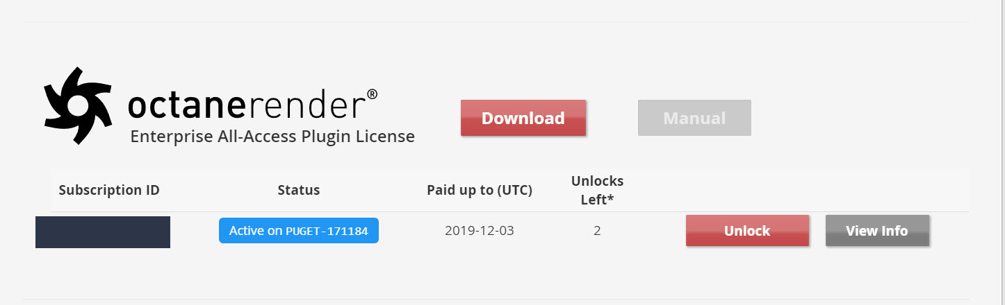

sfshook
Posts: 8
Juanjgon,
I get this console message now I do have the subscription (I think so anyways).
*** OCTANE API MSG: ORC user subscription status could not be retrieved: The server returned a client-side error with HTTP code: 401
*** OCTANE API MSG: ORC subscription status cannot be found
It doesn't seem to bother any of the actions.
I have attached my subscription screen shot.
Thank you,
Steve
Octane subscription
Octane subscription
