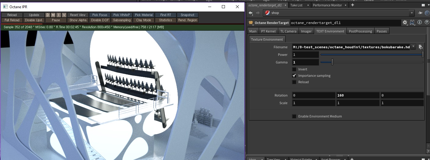

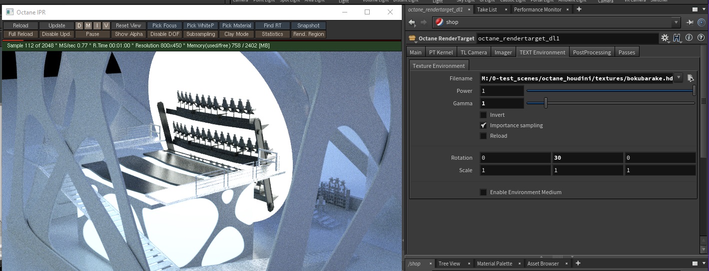

Hi,ptunstall wrote:Hey Juanjo, I have an odd issue. When I add an image to the Texture Environment and I turn on the IPR and rotate it the IPR doesn't seem to update properly. The lighting gets dark and I have to do a reload to get it to render properly.
Sorry, but I can't reproduce this problem here. Can you please send me a test scene with this issue and the exact steps to reproduce it?

Sure here you go! https://www.dropbox.com/s/a6g4ij4hastkj ... e.zip?dl=0. Could to be scale related?
Basically if you rotate the texture environment on the Y-Axis you'll see it update inthe IPR but it gets dark and doesn't represent the IBL correctly until you hit reload.
What a weird issue. Here I can rotate the environment texture and the IPR updates the scene without problems. Can be an issue related to your HDRI image? I don't have it here to test it.
I suppose that you are using this latest build, right? Do you know if this problem is something new, or do you have it also with earlier versions?

Oddity!
Ok just made a whole new scene and plugged in a different HDRI same issue. I was thinking it was potentially the net render pulling 10 GPUs but that wasn't the case either...
Guess we need to get into versions of houdini now? maybe OS? I'm using 16.0.557 on Windows 10.
Try an HDRI with a "sun" in it where you get hard shadows as that seems to be actually what's effected. Might be related to importance sampling or something.
