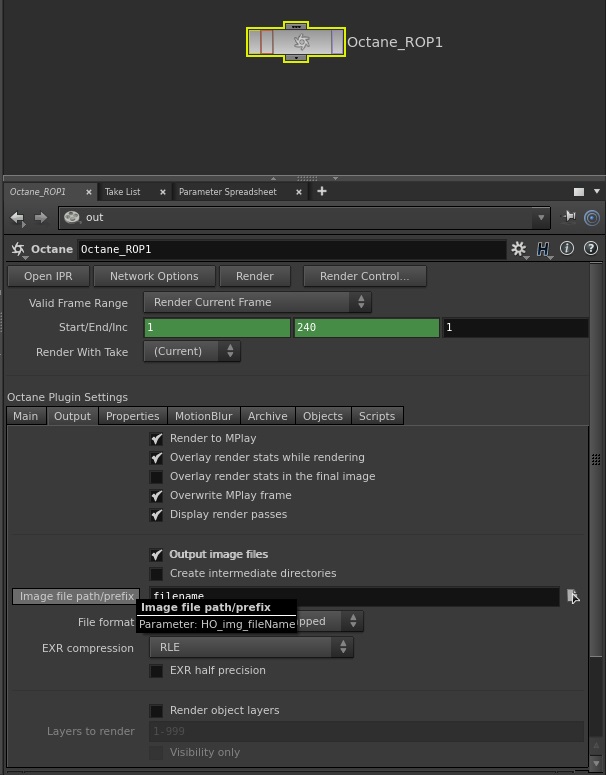

The Octane ROP image files output path parameter is "HO_img_fileName", so you could try to add to the script these lines, in def GetOutputPath( node ): function
(The type of the node can be also reported as elif type == "Octane_ROP": ... I am not sure)
Let me know if it works. If you need to know more parameter names of the Octane ROP, you could also get them sliding the cursor over the parameter, as you can see in the attached screen grab.
-Juanjo
Code: Select all
elif type == "Octane":
outputFile = node.parm("HO_img_fileName")Let me know if it works. If you need to know more parameter names of the Octane ROP, you could also get them sliding the cursor over the parameter, as you can see in the attached screen grab.
-Juanjo
