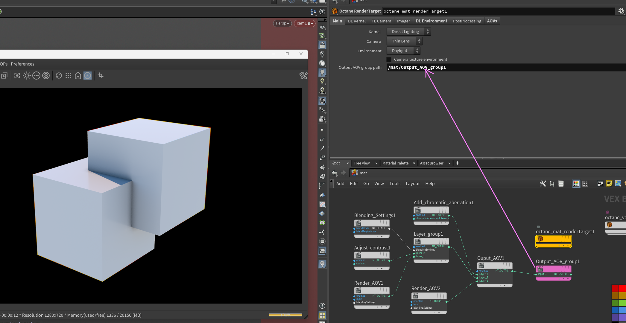

Is the new Output AOV group working? Can't see anything nor there is a setup-guide in the document.
ricky_otoy
Posts: 289
Joined: Mon Jun 19, 2023 6:34 am
LewisO wrote:Is the new Output AOV group working? Can't see anything nor there is a setup-guide in the document.
The attachment abc.png is no longer available
Hi Lewis, you are missing an Output AOV to plug into the Output AOV Group. For any AOVs you use in the setup, you will still need to first enable them the usual way.

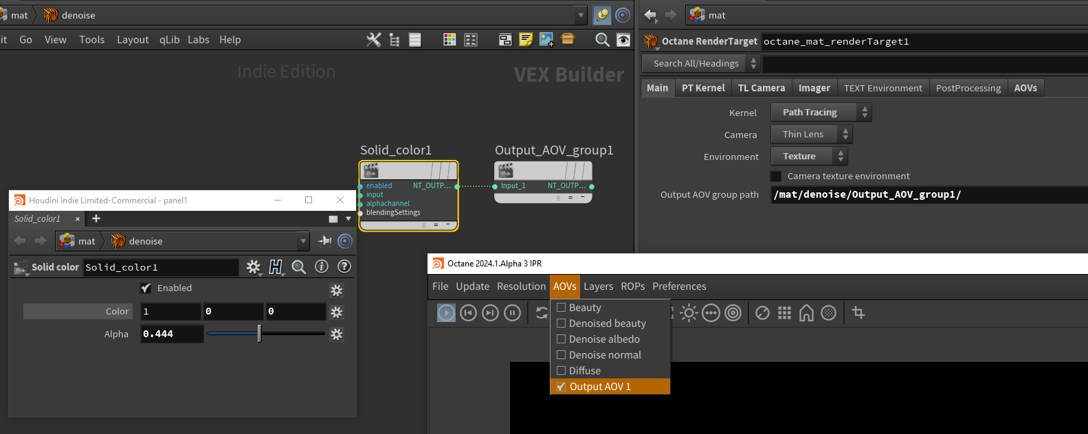

Hi Ricky thanks for the reply, I *sort of* got it to work, partially. The problem is that the Open Image Denoise does not work, it outputs black result.
Basically, I am trying to figure this out, it would be great to get some sort of info/insights on this specific topic viewtopic.php?f=33&t=83364&p=432682#p432682

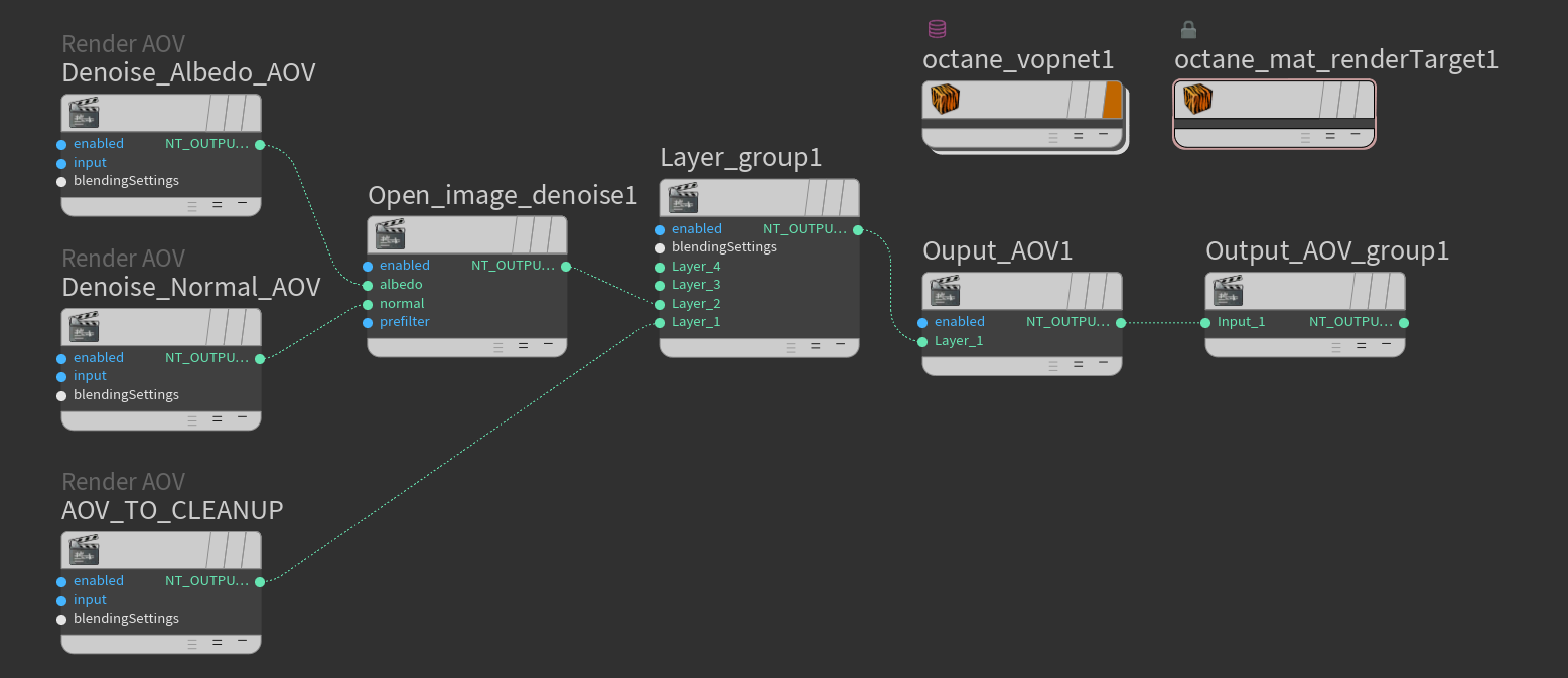

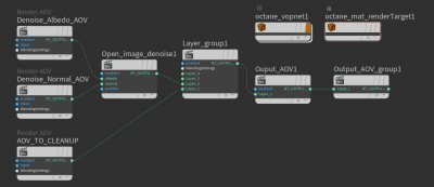

Hi there, you should use the "Render AOV" node and choose the appropriate AOV from that instead. The pin output doesn't match the input needed. (Also use a layer)

ricky_otoy
Posts: 289
Sorry thought I posted a screenshot.
Hope it helps!
