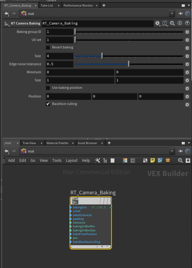

I just wanted to bake to texture using octane but it seems we have something less than c4d and it is octane camera properties (like c4d camera tag) or at least I cant find it.

The camera baking node should have the same parameters found in Standalone. What do you think that is missing?
Thanks,
-Juanjo

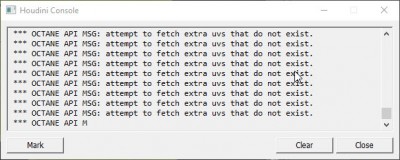

I changed my baking layer id to 2, uv set to 2 and there is only one geo in scene but starting the ipr to check baking I get 100s of these errors. (attached)
Render looks okay but takes much to start.
What can I do to don't see errors?
juanjgon
Posts: 8867
Location: Spain
Can you please share this scene to take a look at it here? Perhaps you are trying to use a not available UV attribute or something like that.
