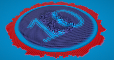

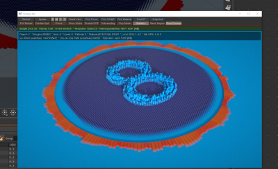

I've try to render this countdown scene (thanks to Rohan Dalvi) and if I render a single frame all is ok :
But as soons as I try to render animation I have this
Any idea ?
Here is my file https://www.dropbox.com/t/0vQqiwsESMMsRNaX
Thanks for your help
and not correct screenshot from the animation
This is correct - Single frame

You probably need to turn on Full Scene Reload in Rendering Mode.

galleon27 wrote:You probably need to turn on Full Scene Reload in Rendering Mode.
ok you're right tthanks for your help
juanjgon
Posts: 8867
Location: Spain
Yep, probably this scene is using a workflow that is not compatible with the update scene mode while rendering sequences.
