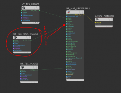

How to select a Channel in a Mask Texture?
Moderator: juanjgon
you need to create a OSL shader, copy this code and compile it. It output the RGBA separately :

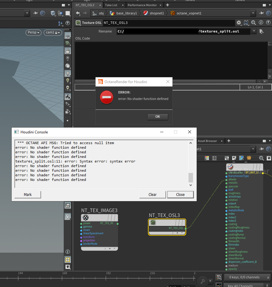

sorry I dont know what I had this script above, I not test it. For alpha I have not tested too.
try this, it works with RGB :
shader OslTexture(
color r = 0,
color g = 0,
color b = 0,
output color c = 0)
c = color(r[0],g[0],b[0]);
maybe you can add alpha try :
shader OslTexture(
color r = 0,
color g = 0,
color b = 0,
color a = 0,
output color c = 0)
c = color(r[0],g[0],b[0],a[0]);

color g = 0,
color b = 0,
output color c = 0)
shader OslTexture(
color r = 0,
color g = 0,
color b = 0,
color a = 0,
output color c = 0)
