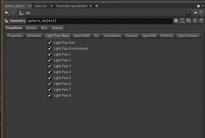

I know how to set light IDs and enable it in ROP
But I can't find the the setting that which one geometry be effected by different IDs.

The light pass mask at the object level can be configured using the options available in the Octane OBJ spare parameters, Light Pass Mask tab.

haha, sorry, I forgot to renew my Octane spare parameters after updating the OC plugin
