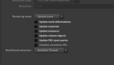

When I render with "Render to disk," the plugin loads in the whole scene every time. Every frame, it loads the whole mesh and sends it to my render slaves; that takes a lot of time, even if it's only camera movement (of 100kB), it sends the whole scene (like 100MB). I tried these "octane update" buttons, but without any effect. Is there any mystical button I can use (like those D,M,I buttons)?

What update options do you have enabled? If you are rendering a sequence with an animated camera only, you should disable all the "update" options that are not needed in your case.

I tried those checkboxes, but they have no effect. It doesn't matter if I check or uncheck them, it's the same... :(
Is there any other button I have to activate?
Rendering mode is set to "Update scene" and Multithread extraction is "Disabled."

Hmm, but are you talking about the scene extraction time/local GPU update, or the scene updating in network render nodes? At least in the local machine, the scene updating in "update scene" mode with all the update options disabled should be really fast, like the IPR ...
