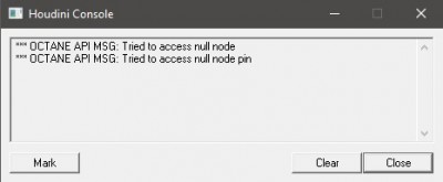

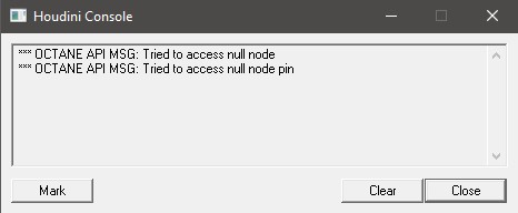

- When Rendering to Custom OpenGL - I cant see anything (intuitive) to stop the IPR render. When Rendering to MPlay, the Halt Current Render button and its HotKey (Escape Key) stops the IPR render.
- Mouse Scroll - When rendering to MPlay, the IPR responds very smoothly to Mouse Scroll and does not lag when Mouse Scroll events are created quickly. When rendering to Custom OpenGL, the IPR is very laggy and seems to que the Mouse Scroll events sequentially - such that, if you close the Custom OpenGL window PRIOR to these Mouse Scroll events being processed by Custom OpenGL, you receive the following popup:

I suppose that in the OpenGL window you could use the "Pause" button to stop the rendering. Internally probably from the GPU point of view it is the same that stop the rendering.
Let me check why the OpenGL IPR has this behavior, perhaps it is a side effect of the raw OpenGL window running over the Houdini OpenGL viewports, but I'm not sure.
