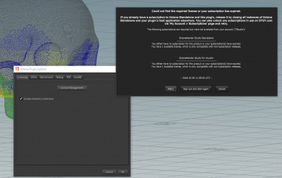

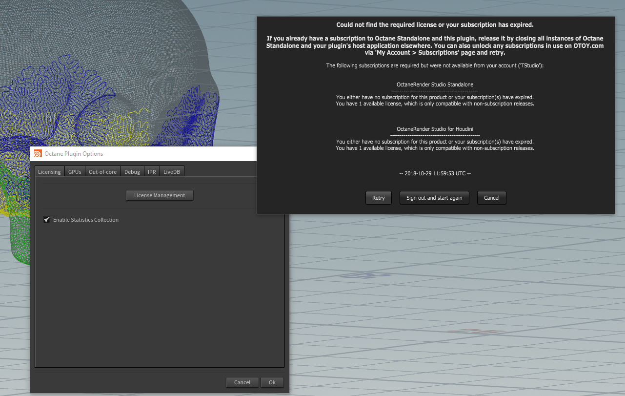

On more thing…. How can I activate octane ?
I got this message…. I`m using standalone, modo plugin, C4D plugin with no problem. I have Standalone licence and 3 plugins.
Hmm, if you have regular commercial licenses you should not install the plugin version for the subscription licenses.
In your case, the "Octane_3.08.5.0_Houdini_16.5.571_vr_Win64" plugin is for subscription licenses. For a regular license, you must use the "Octane_3.08.5.0_Houdini_16.5.571_Win64" plugin.
https://render.otoy.com/customerdownloa ... _Win64.zip
Thanks,
-Juanjo
Thanks,
-Juanjo
