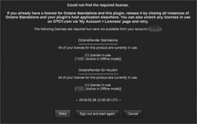

When I try to render this message I get:

One sec. The messages reported say that the licenses are activated in offline mode. Do you have this option enabled when you activate the license? ... in offline mode the license is not released until you release it by hand from the Standalone using the sing out option, I think ...

I think that somehow the main problem is that your system is enabling the license in offline mode. In any case, I hope that soon we are going to have the next plugin build available. If the problems continue with the new build, we can further investigate this issue.
